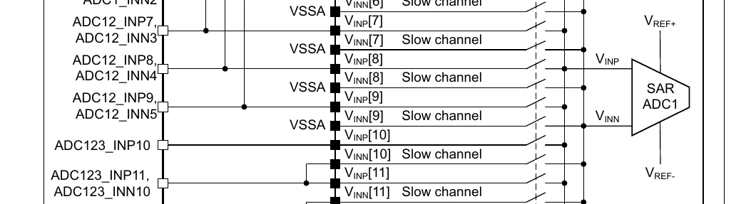

Where can I find the ADC input impedance of STM32H743 in differential and single-ended configurations?

For the STM32H7 datasheet the R(AIN) formula given in the other STM32 ADC datasheet section is missing. You can apply it for the H7
December 19, 2018
The datasheet also doesn't have the sampling switch resistance value which is required by the formula.
December 19, 2018
Is it the same for both differential and single-ended inputs?

Issue #2: Radc not specified in data sheet
  • Datasheet DS12110, revision 6 is still missing Radc.
  • Figure 41 shows RADC and the footnote says it is in Table 87. Unfortunately, it isn't.
  • Figure 93 shows RADC and the footnote says it is in Table 184. Unfortunately, it isn't.

Yes, so: 5-years later, everybody found its answer - or nobody cares of the 6pF switched to IN , or +IN and -IN .
+ You seen, what i wrote about the input "impedance" of this kind of ADC.
...as from rm :  the sampling cap /input is just switched to +in / -in , instead of +in /vssa :
Thats all.

R-in = 1 / ( 2 * PI() * C * F ),
where PI() - math constant 3.14...,
C - sampling & hold ADC capacitance provided in DS,
and F - sampling rate in Hz.

I have been testing the ADC input impedance of the STM32H743 and have observed the discrepancy between DC and AC impedance measurements.
DC Measurement:
Using a bias resistor method, I measured a DC input impedance of ~709kΩ, derived from a 22kΩ bias resistor dropping 0.49V off a 1.61V reference voltage, indicating a 2.2µA bias current.
AC Impedance Expectation:
For an ADC sampling rate of 192kHz and a sampling capacitance of 6pF, the expected AC impedance should follow:
Rin = 1 / (2π × fADC × CADC)
Substituting the values:
Rin = 1 / (2π × 192kHz × 6pF) ≈ 138kΩ
This suggests that while the AC impedance could be 138kΩ, the DC impedance is significantly higher at 709kΩ.
Clarifications Needed:
  1. Is this discrepancy expected? Does the ADC input exhibit different impedance characteristics at DC versus AC due to internal switching behavior?
  2. How does bias current influence ADC performance? Are there known effects of steady-state bias currents on charge transfer dynamics?
  3. What is the recommended bias current for optimal ADC operation at 192/384 KHz sampling rates? Should biasing conditions be adjusted to ensure accurate sampling behavior?
  4. Are there recommended methods to experimentally verify the true AC impedance seen by the ADC input?
I would greatly appreciate any insights or guidance on these points.

Thank you for your response. Let me clarify my concerns:
  • I understand how this type of ADC works, but I am investigating whether the difference between DC and AC impedance is expected behavior due to internal ADC switching dynamics.
  • I am not requesting chip design details, but rather an explanation of whether this impedance discrepancy aligns with typical ADC behavior.
  • I acknowledge the recommended ADC input impedance from the datasheet, but my real-world measurements show a different behavior, which I would like to understand.
The ultimate aim of my inquiry is to determine whether my design could be improved to enhance sensitivity to weak signals or reduce noise. If internal ADC effects influence input impedance differently at DC versus AC, this could impact front-end signal conditioning.
