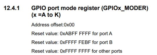

Hi @TAcha.1​ ,
Look to the reset values of GPIO registers in the reference manual (RM0399) to get the exact answer. Here an example:0693W000008wWopQAE.png

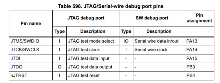

Pins used for debug purpose are the ones where there is an exception:
0693W000008wWnDQAU.png-Amel
