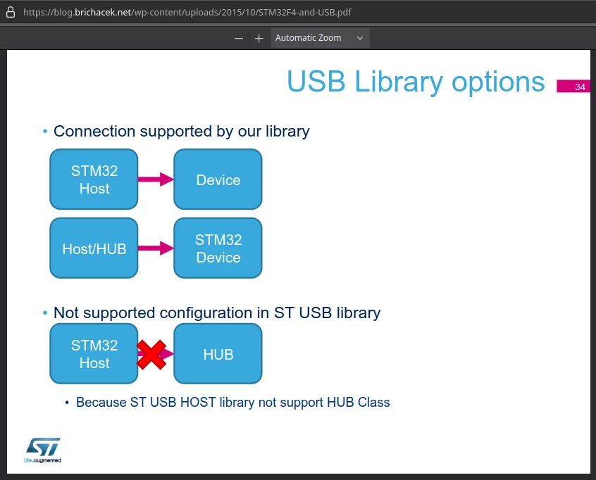

Hi, I'm rethinking the board, to use USB external PHY, but I will need support for the HUB class, where can I find an example of use for STM32F4?
I found a presentation by Roman Ludin (September 2014) where the document says that the library does not support the HUB Class. Next year it will be 10 years since this presentation was made, has anyone managed to provide at least an example of an implementation of the HUB class with an external PHY?

*The* Library still does not support it, but there are other libraries. Yes, in 10 years a lot of new things arrived, more interesting than the F4 and USB 2.0.  Where people do search these days? You know. Yandex left the scene but Google still rules, and there is chatgpt. Knowing Chinese really helps. Enjoy...

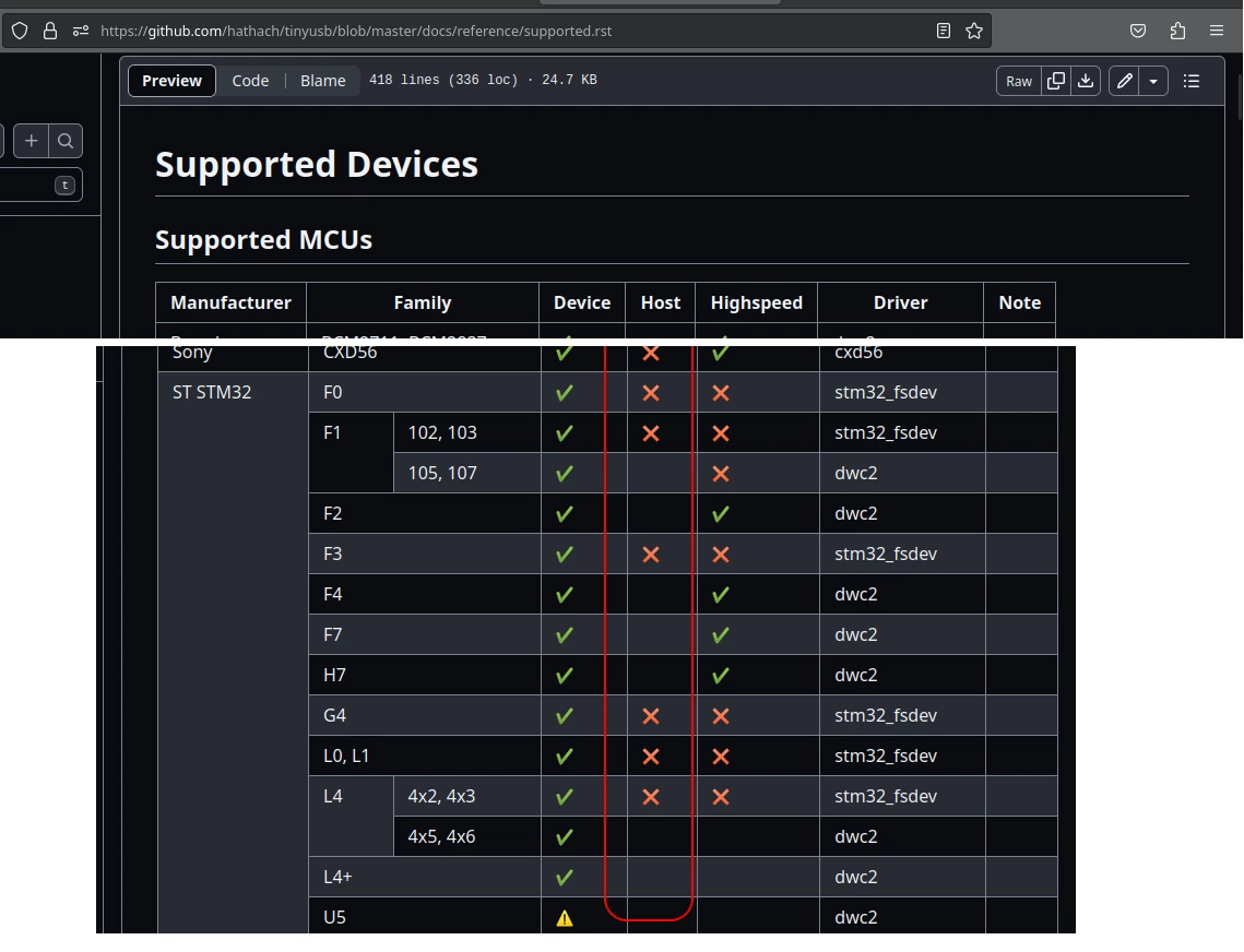

Someone has already mentioned this library on other occasions, I don't know why they keep insisting on it.
TinyUSB supports STM32 in Device mode, but not in Host mode.

Indeed it seems the host mode drivers are available for just a few series of MCUs. Well, if your goals are important, you can implement/port a driver for STM32 and upstream it. ;) In the long term it could even be easier than fixing and implementing a workarounds for ST's USB stack.
Because, contrary to ST's USB stack, it is developed by people, who understand what they are doing, and it is not a broken bloatware.
