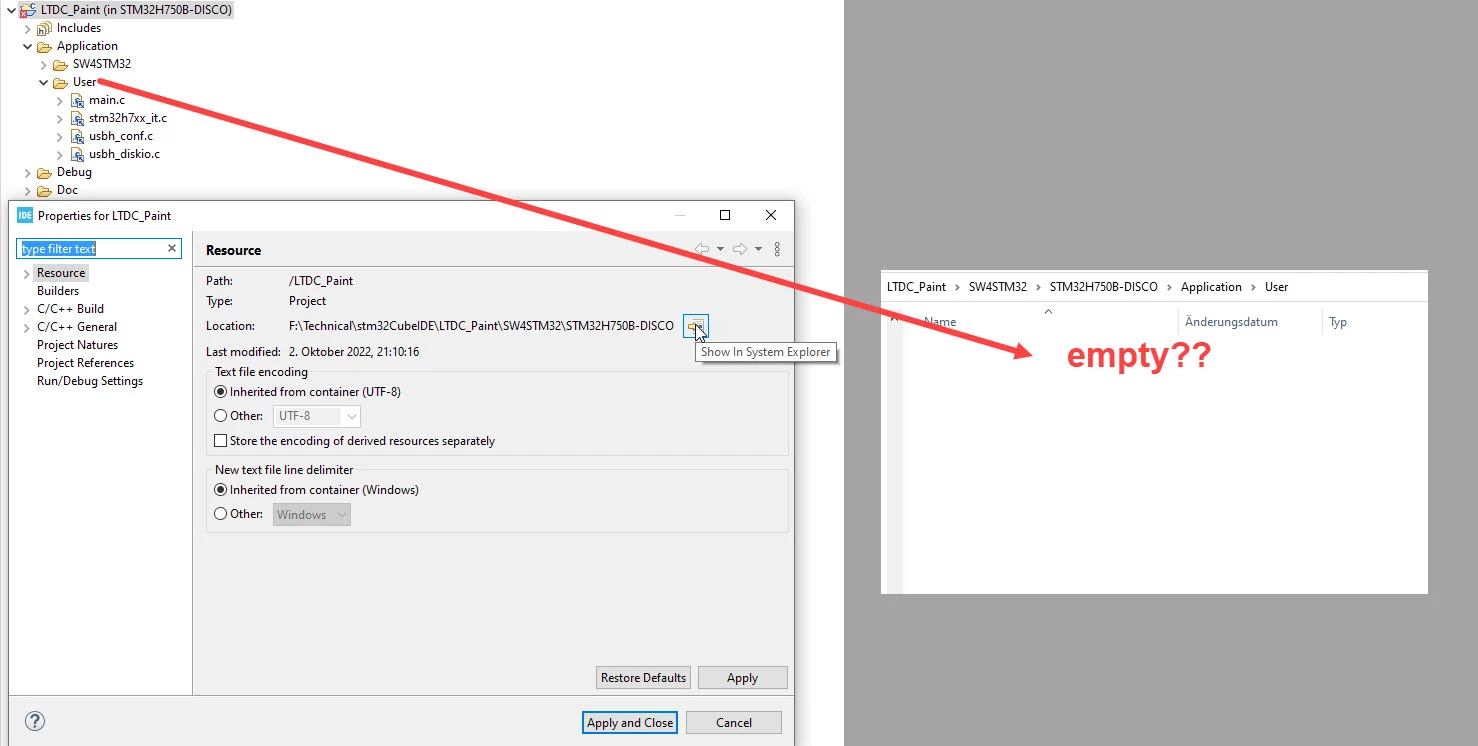

Where are the project-files, empty folder?
I have created a sample project from Stm32CubeIDE, but there are no files in the specified location folder, see attached image.
I do not understand this? Where are the files? How is this linked?
Thank you

It is probably a bit irritating, but Eclipse as the basis of STM32CubeIDE creates its own folder structure in the project, which does not necessarily correspond to the one on your physical project folder. At least what is labelled "User" in your screenshot has nothing to do with the Application\User folder.
Depending on the tool creating your project (STM32CubeIDE, TouchGFX, etc), you will find the files main.c, etc in the directories e.g. <prj>\Src or <prj>\Core\Src.
To find out the exact location of e.g. main.c in STM32CubeIDE:
  • right-click on the file name
  • select Properties, which lists
    • Eclipse path
    • location
    • Resolved (physical) location
Does it answer your question?
Regards
/Peter

Ok, I see. Thank you

maybe one more question, if I insert an additional file at this location (see attachment picture), the file is not displayed in STM32CubeIDE.
How do I link this correctly?
Peter BENSCH
October 13, 2022
Inserting at the physical location is not sufficient because Eclipse does not permanently scan the (physical) folder structure for new files and therefore does not notice this.
Instead, you have to add a new file (source, header, etc) within the STM32CubeIDE, e.g. by drag'n'drop into the project. Details can be found in the reference manuals for the STM32CubeIDE, e.g. UM2553 or UM2609.
