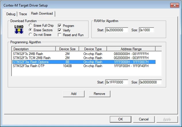

    The method in Keil is to direct content to a specific section/load-region, and then select a flash algorithm that manages the option bytes. Figure structure, attribute, scatter file/linker script, and programmer that deals with the .HEX
    The more practical method of dealing with options and settings is to have the code determine if it is on an freshly programmed device and push default settings.
