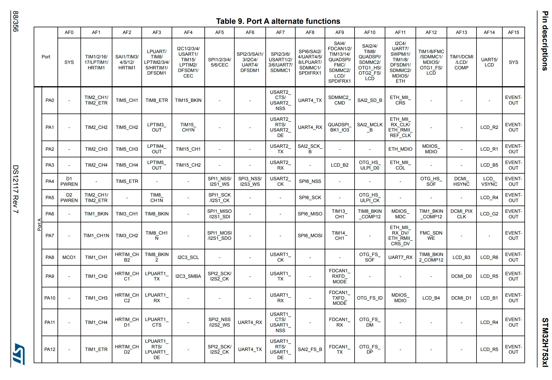

Where are defined AF numbers for pins?
I have a project for H743 with three SPIs.

Notice that for SPI2 all pins have AF=5, but for SPI3 some pins have AF=6 and some AF=7.
How one can discover these values, besides of reading Cube generated code (or templates)?
These AFs are defined in stm32h7xx_hal_gpio_ex.h.
For AF=5 there are definitions for SPI1 to 6.
For AF=6 there are definitions for SPI2 and 3.
For AF=7 there are definitions for SPI2,3,6.
So, how one should guess which value to use for SPI2 and 3?
I could not find this info in DS12117, neither in RM0433.
TDKBest answer
Jun 27, 2021 3:42 AM UTC
They are in the datasheet, page 88+.
https://www.st.com/resource/en/datasheet/stm32h743bi.pdf
Your question says H743 but DS12117 is for H753. Perhaps a typo.

Pavel A.
Pavel A.Author
Jun 27, 2021 3:56 AM UTC
Thank you. Could not make it thru table 8...
