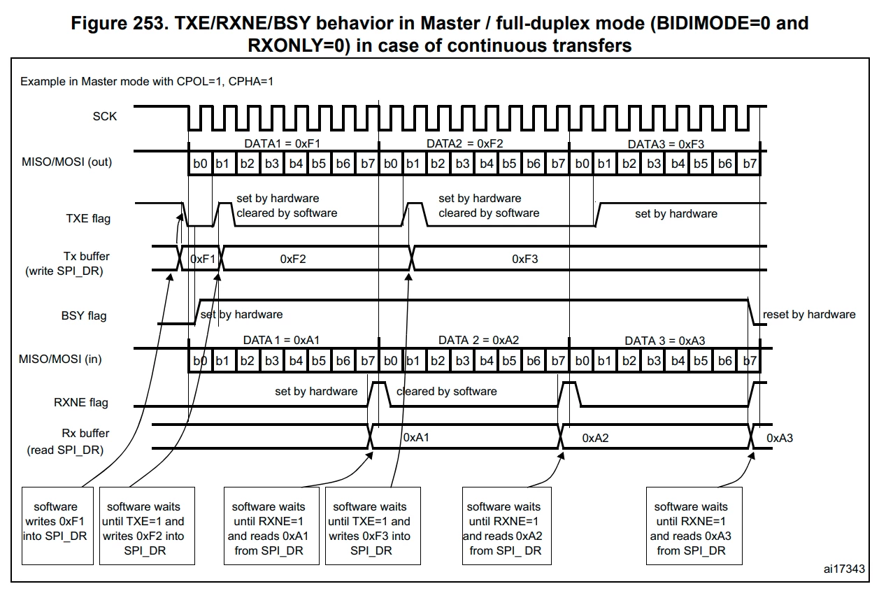

In the last figure, at the green arrow, RXNE transitions from 1 to 0 when the 0xA1 value is read from SPI->DR. RXNE goes back to 1 when the next data (0xA2) is available to be read.

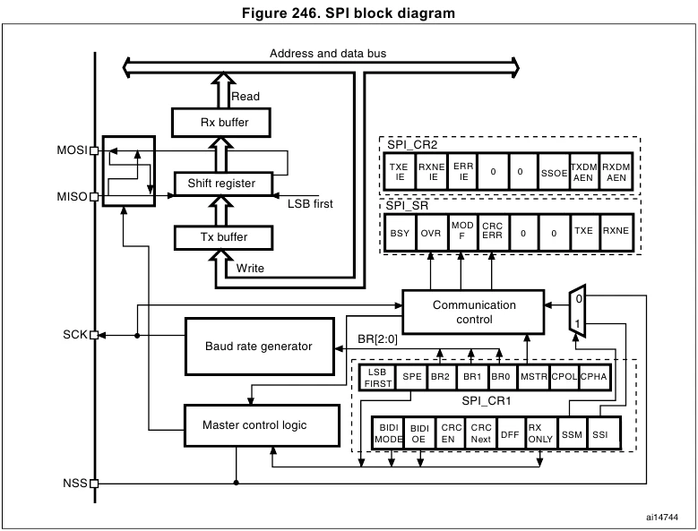

> It's hard for me to imagine that the SPI_DR register keeps track of when SPI_DR will be read.
You should think of SPI->DR as a hardware interface, not just a register in memory. The SPI peripheral has an internal state machine that respond to reads and writes to this interface appropriately. That's why reads always show incoming data and writes always send data out.

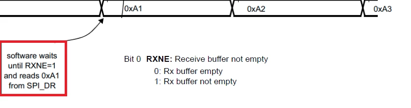

pr.pngWhile the RX buffer is full, the SPI_SR_RXNE bit is 1.
The instruction in the image above suggests reading data from the SPI1->DR register while the RX buffer is full.
But the RX buffer and SPI1->DR are not the same thing.
Let's say a situation occurs when the RX buffer is full, I read the SPI1->DR data, but the data from the RX buffer has not yet reached the SPI1->DR register.
It seems strange to me that there is no indicator indicating that data has reached the SPI1->DR register from the RX buffer.
TDKBest answer
Maybe at some technical standpoint they are not the same since SPI->DR is a hardware interface, but for the purposes of reading data, they are effectively the same.
When RXNE is asserted, there is data in the RX buffer. The RX buffer is read by reading SPI->DR, which clears RXNE. There is no intermediate step or race condition here.
Not seeing any contradictions in the RM.

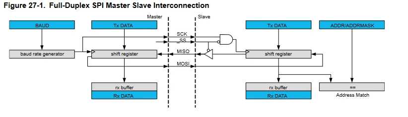

My last drawing was wrong, I deleted it)
Ok, are SPI_DR and RX buffer the same thing if the purpose is reading?
Maybe you know where I can read this from official sources?
I can’t understand why SPI_DR and RX buffer are the same thing if they are physically located in different parts of the microcontroller.
The image shows that RX buffer and RX Data are different parts of the Microcontroller even for reading.
Transferring data from different parts of the Microcontroller takes a certain time.
The RX buffer is full, but we are reading RX Data Register, I don’t understand.
October 23, 2023
Again, think of SPI->DR as an interface, not a memory location. It's not a memory location. Nothing is stored there. When the CPU gets a write to SPI->DR instruction, it puts that data into the TX buffer. When it gets a read instruction, it gets data from the RX buffer.
