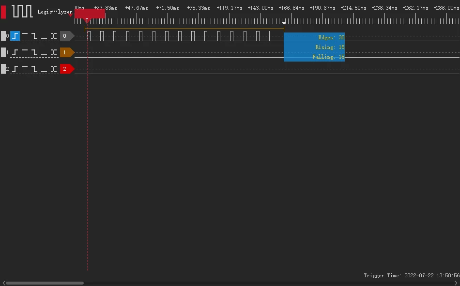

I try to use TIM_DMABurst to generate exact number of pwm pulses.
But I found after call HAL_TIM_DMABurst_WriteStart and HAL_TIM_PWM_Start, it enter HAL_TIM_PeriodElapsedCallback. And then if I call HAL_TIM_PWM_Stop it will stop and generate no pwm. If I call HAL_TIM_DMABurst_WriteStop and HAL_TIM_DMABurst_WriteStart it will continue generate PWM but the wave is wrong
    5 replies

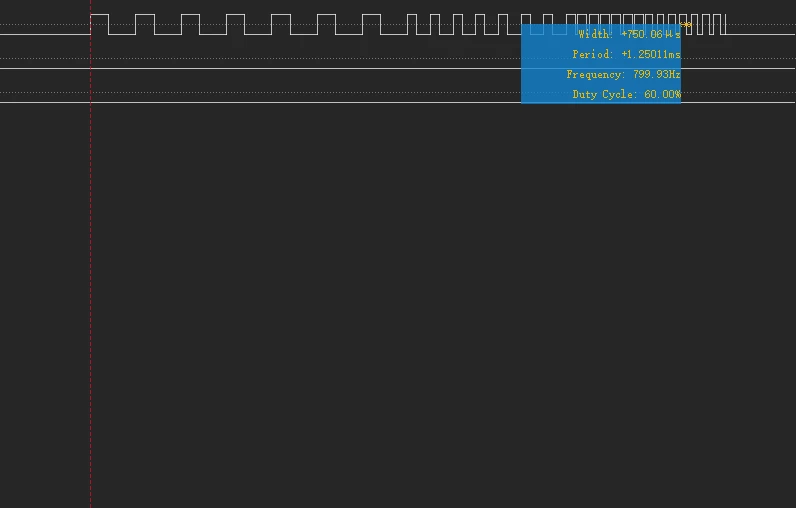

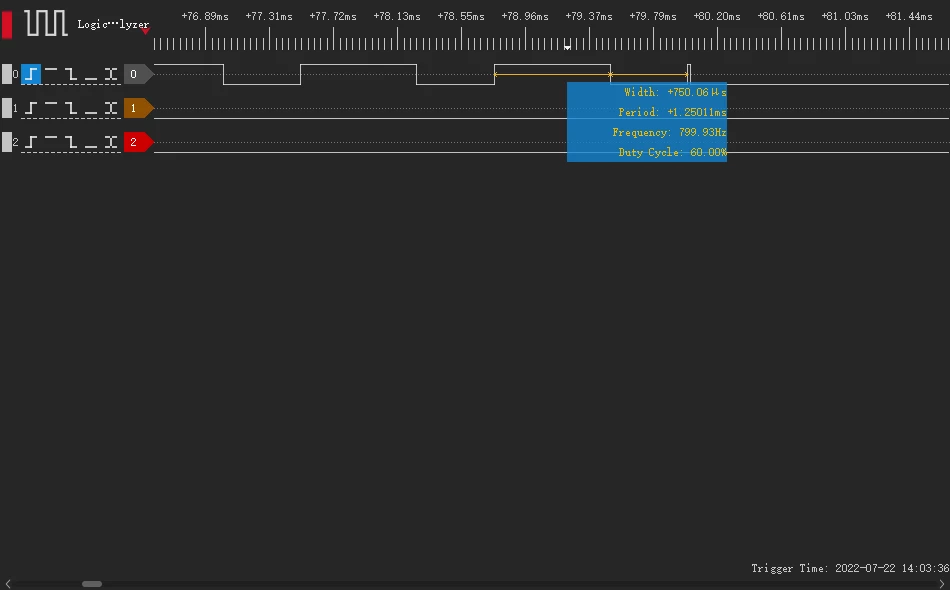

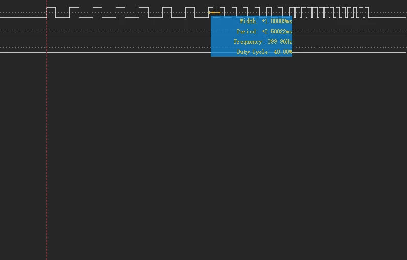

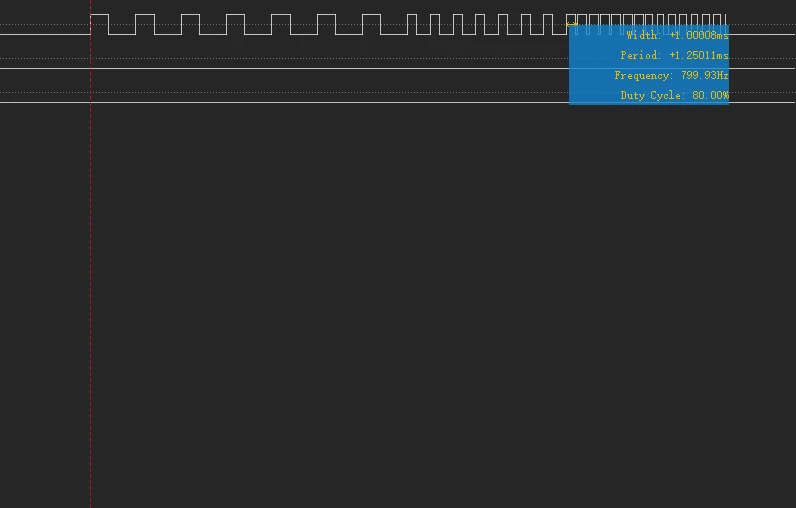

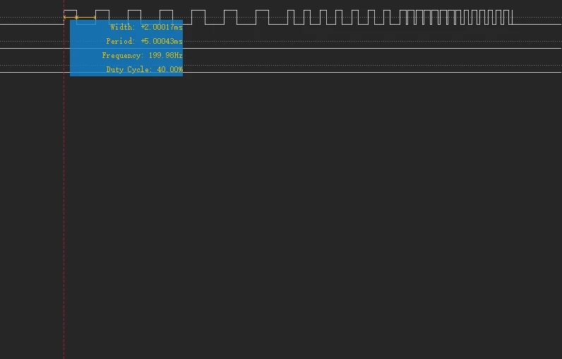

    dming.4
    dming.4Author
    July 22, 2022
    The core like this
    First start TIM_DMABrust with
     aSRC_Buffer[0] = 7200 - 1; /* ARR */
     aSRC_Buffer[1] = 7 - 1; /* RCR */
     aSRC_Buffer[2] = (aSRC_Buffer[0] + 1) * 0.2; /* CCR1 */
    and then in the HAL_TIM_PeriodElapsedCallback change aSRC_Buffer
    	 if (g_irq_cnt == 1) {
    		 aSRC_Buffer[0] = 3600 - 1; /* ARR */
    	 } else if (g_irq_cnt == 2) {
    		 aSRC_Buffer[0] = 1800 - 1; /* ARR */
    		 aSRC_Buffer[2] = (aSRC_Buffer[0] + 1) * 0.4; /* CCR1 */
    	 } else if (g_irq_cnt == 3) {
    	 aSRC_Buffer[0] = 900 - 1; /* ARR */
    	 aSRC_Buffer[2] = (aSRC_Buffer[0] + 1) * 0.6; /* CCR1 */
    but i get pluss like that

    waclawek.jan
    July 22, 2022
    Which STM32?
    But why?
    The point of DMA is, that it works without your intervention. So just define a long enough buffer to hold all the changes, and run the DMA and you're done. A nice trick to stop is to add one more set at the end, where ARR=0.
    dming.4
    dming.4Author
    July 22, 2022
    stm32f103
    I use this timer to driver a step motor ​ so it must be stop at the target point. Amd the problem is the wave generate by mcu is wrong. Use dmamultiwrite do not fix.
