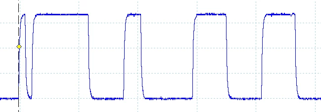

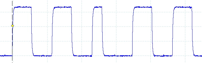

This is correct transfer of 11011
0693W000008xUxmQAE.pngThis is the very first transfer whose first bit is scrambled because of initial DMA request:

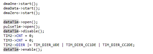

When I do not enable DMA requests, enable the TIM3, disable it, reset TIM2->CNT and TIM3->CNT, enabling DMA request, reanable TIM3 the very first pulse is also generated correctly.. As I mentined the remaining cycles are correct.. Like the following code:
0693W000008xUy1QAE.png I am using my own library. However, I think the names are self evident..
I've a workaround, but I want to understand why TIM2 generates DMA request when it is enabled even if the counter has not reached configured state..

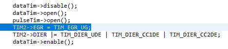

Ok, it's definitely the prescaler.. When I write the following code, first pulse is generated correctly as well..
0693W000008xWSRQA2.pngEnabling disabling the timer caused TIM2 to run at full speed and reload the prescaler, which is done here by setting EGR's UG bit..
I need to update my HAL code such that it will force prescaler to be updated for the first run if the prescaler is different from the current value and the timer is not running and the CNT is 0..

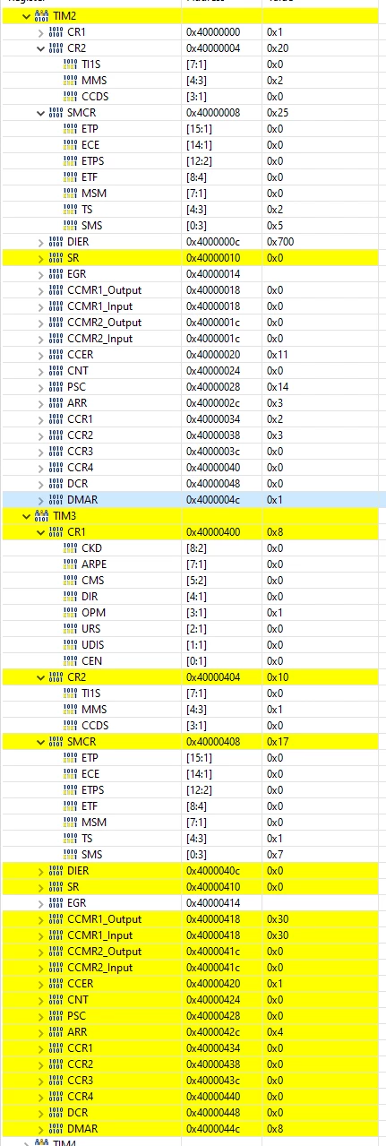

This is the initial configuration just before dataTim's enable..
0693W000008xWQQQA2.pngIf the compare's are set to 2 and 3 how can they generate DMA request at start?
My mistake might be prescaler is being updated after first cycle.. It looks like TIM2 runs at full speed for first cycle, but recovers after the second..
