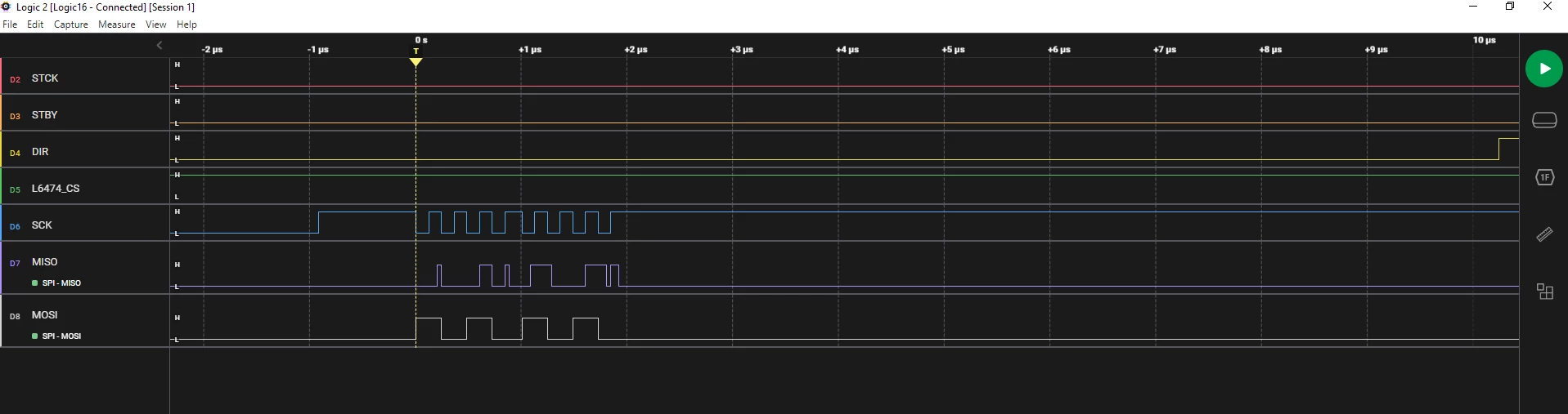

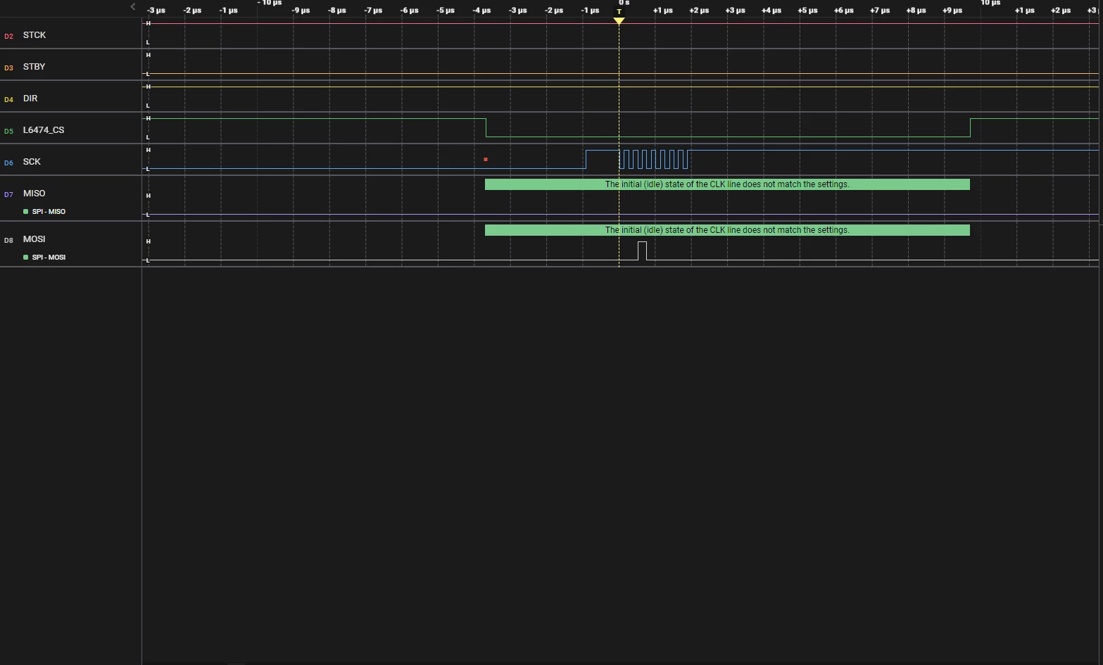

The L6474 uses SPI in MODE 3 where CPOL = 1 and CPHA = 1
My logic analyzer is saying that having the SCK low when the CS is pulled low or enabled the idle state of the CLK (a.k.a. SCK) is not correct for MODE 3. After the first transaction the SCK stays high as expected.
0693W00000Y8SZ6QAN.pngIt does not appear there is a way to set the line to default high at startup.
Maybe I just do not know how to do it.

Which STM32?
I don't know how do you handle CS, but it should have nothing to do with it.
Try simply set up the GPIOs, set the SPI clock in RCC, set the two bits which set CPOL and CPHA and set CEN and then just infinite loop. This is simple enough so that you really don't need Cube/HAL for this - you can even do it without writing code, just clicking in the registers view in debugger.
Still SCK low?

This is for the STM32L443CC but I doubt if it is an issue for a particular processor.
I handle CS outside of the HAL.

I do not know if this is the best answer, but I decided to write to the spi without lowering the CS pin.
The write left the SCK high, and everybody is happy when I go to actually read parameters, SCK s not left in an invalid state.
