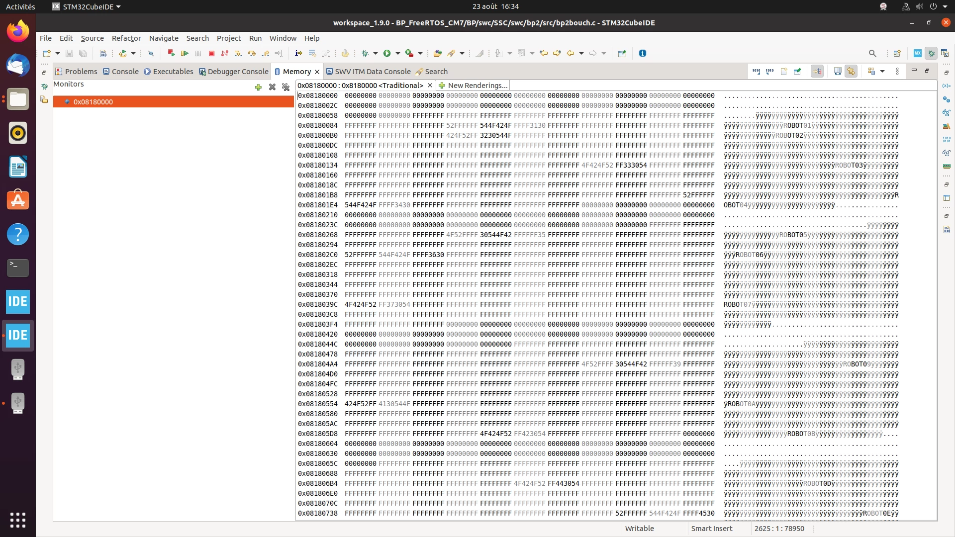

When flashing code on STM32H7, blocks of 0s appear in reserved flash memory.

However, as soon as I flash my code, an apparently random number of 0s are written in the flash sector where I wrote during last execution. The blocks of 0s are all the same size though, and appear periodically every 0x200 bytes (at 0x08xxx000, 0x08xxx200, 0x08xxx400, 0x08xxx600, etc... - see attachments). The rest of the data I wrote are still here, and other sectors aren't affected.
Any idea what could cause this ? I tried to use watchpoint to see when this could happen, but without any success. Any help will be greatly appreciated.

After further testing, it seems that the problem starts appearing not after writing to the flash and flashing the code again, but when the flash sector is erased and the code is flashed again afterwards.
Also, the size of the blocks of 0s seems to be influenced by the FLASH_VOLTAGE_RANGE value used when erasing the flash. The bigger the number, the bigger the blocks, but their size still vary each time I flash my code on my board.
Any help would still be appreciated.
Try to use only the minimal value (slower, yes). Check that the power to the MCU is stable.

Perhaps dump the memory from the MCU?
Have a Hard Fault Handler set up and reporting useful data.
Could it be sections are unwritten?
You show a bunch of code, but not how it is used/utilized
Units here look mismatched, is the basis 32-byte aligned?
		if (HAL_FLASH_Program(FLASH_TYPEPROGRAM_FLASHWORD, StartAddress, Data) == HAL_OK)
			StartAddress += 32;
			Data += 8;
			size -= 8;
What does size count? 32-byte / 256-bit chunks
128KB is 128 * 1024, not 128000
