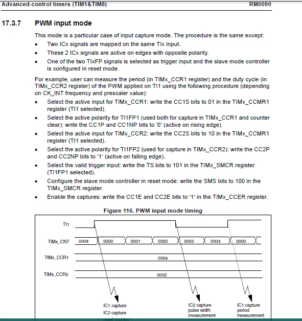

Take a look at this approach from St
It's from RefManual of F4 series
After you start HAL_TIM_IC_Start(..) you can continously read the  captured values of CCR1(Period) and CCR2(Pulse width)
There is an example also in F4 firmware (HAL) for PWM Input.

You gave the answer by yourself -> 'Do i have to configure the single timer channel for slave mode too or how do i reset the counter on the rising edge and capture the next rising edge so i get the period?'
An example for Ch. 2
Set channel 2 as Capture Input capturing on rising edges  and set the active input for channel 2 from TI2 (TIMx_CH2)
Set also the timer in slave mode reset  and trigered from TI2FP2. (which means that counter, etc resets at every trigger from rising edge from TI2)
Enable the capture. (no need to use the IT version of HAL_TIM_IC_Start)
The CCRx register will contains the period of measuring PWM signal (frequency).

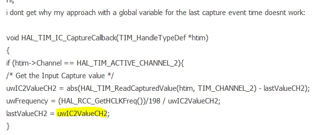

i dont get why my approach with a global variable for the last capture event time doesnt work:
void HAL_TIM_IC_CaptureCallback(TIM_HandleTypeDef *htim)
if (htim->Channel == HAL_TIM_ACTIVE_CHANNEL_2){
/* Get the Input Capture value */
uwIC2ValueCH2 = abs(HAL_TIM_ReadCapturedValue(htim, TIM_CHANNEL_2) - lastValueCH2);
uwFrequency = (HAL_RCC_GetHCLKFreq())/198 / uwIC2ValueCH2;
lastValueCH2 = uwIC2ValueCH2;
if (htim->Channel == HAL_TIM_ACTIVE_CHANNEL_1){
uwIC2ValueCH1 = HAL_TIM_ReadCapturedValue(htim, TIM_CHANNEL_1) - lastValueCH1;
uwFrequency = (HAL_RCC_GetHCLKFreq())/198 / uwIC2ValueCH1;
lastValueCH1 = uwIC2ValueCH1;
Please ignore the HAL_TIM_ACTIVE_CHANNEL_1 branch, its currently not executed because nothing is connected tpo the pin.

Hi
with a first glance, at this part of code
you assigned to lastValueCH2  the difference  and not the last captured value.
The result finaly is not correct.
Also there is not need to take the absolute value of difference. you may treat all variables as unsigned  and the result will  allways correct. (0xFFFFFFFF+5=4  , 4-0XFFFFFFFF=5 for 32 bit operations or  0xFFFF+5=4  , 4-0XFFFF=5 for 16 bit operations)
