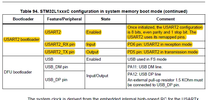

    Can somebody explain what this line means?
    ''The USART2 uses its remapped pins.''
    I'm using STM32L151CCU6 which doesn't have PD6/7. The bootloader isn't ack'ing when PA2/PA3 is used. Shouldn't the PA2/PA3 be the ''remapped pins'' for this case?
