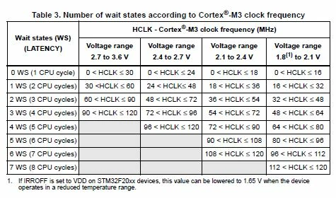

I want to know changing VDD anytime.
I think.
1. change firmware correction VDD(3.3V firmware or 1.8V firmware)
2. change system clock configuration void SystemClock_Config(void) in main.c
--> 7WS
