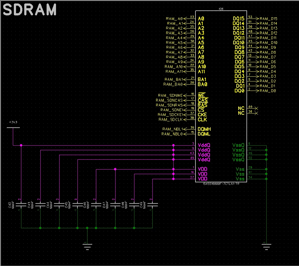

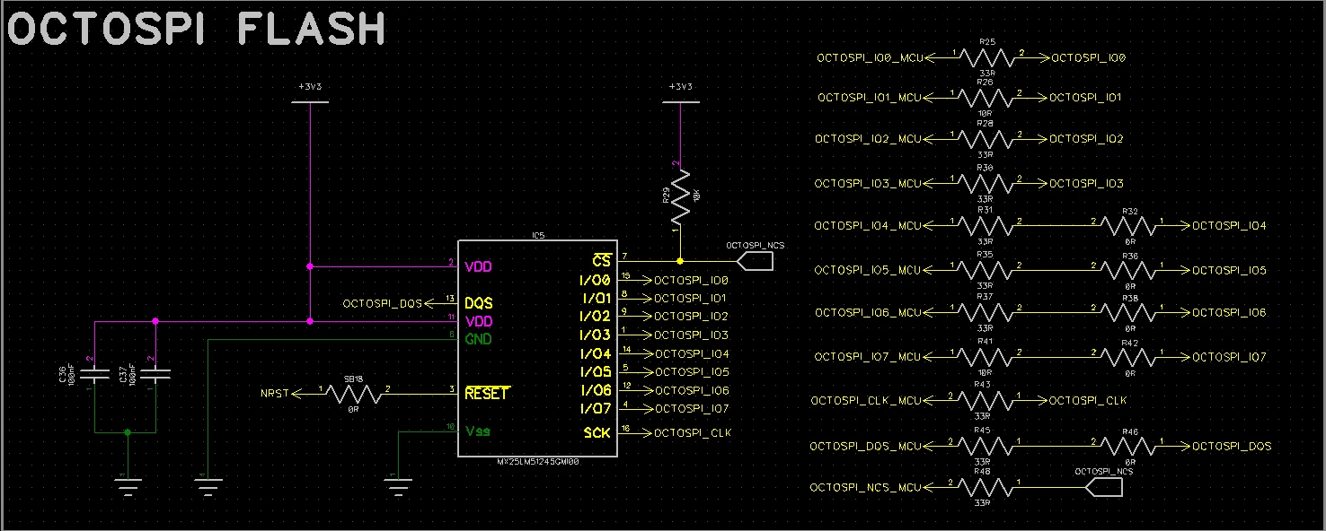

What should be the length of the path to be drawn for SDRAM AND FLASH?
I am using below commponet
MCU: STM32H7B3IIT6
SDRAM: IS45S16800F-7CTLA1-TR
FLASH: MX25LM51245GMI00
I am revising the card design according to high speed signals. But how do I calculate the length of the paths to be drawn for SDRAM and FLASH?
How many mm and how much impedance should it have?

The shorter the better, but it's more important for all related signal lines to be of the same length. And for all high-speed signal lines the best is to optimize the impedance to 50 ohms. That's why you have those 33 ohm series resistors - in series with IC output pin's impedance of approximately 17 ohms it adds up to 50 ohms. Search for a term "transmission line".
For PCB routes target approximately the 50 ohm common impedance with this:
https://www.eeweb.com/tools/edge-coupled-microstrip-impedance/
