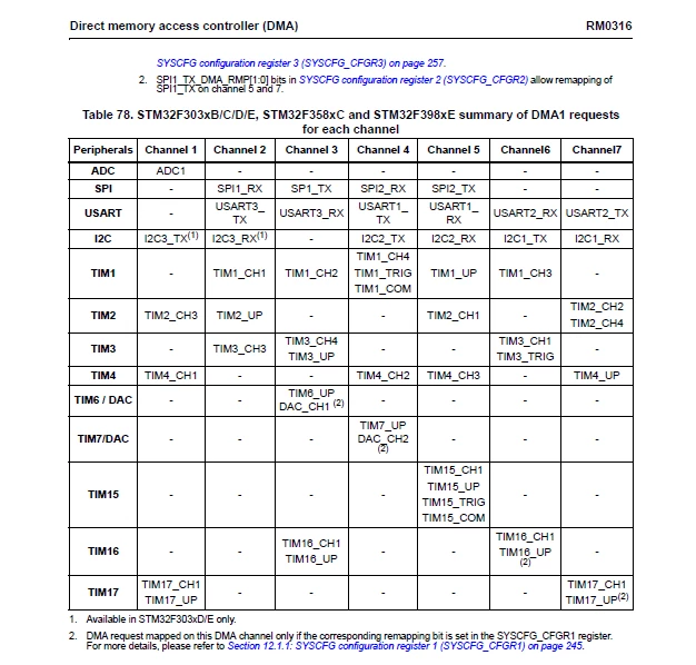

I'm trying to trigger an ADC conversion externally from TRGO2 and store it to a buffer through DMA. However, it doesn't appear that anything is being written to that buffer. Could someone please look through my initialization code and let me know if I'm messing something up during the initialization?

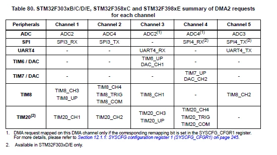

I appear to have solved the issue. Looking further in the datasheet I realized that ADC2 was not connected to DMA1 channel 1
The correct DMA connection to ADC2 is DMA2 Channel 1:

Which mcu?
Did you verify that your trigger source works and the trigger is set properly in timer?
G S
G SAuthor
Nov 16, 2017 6:21 AM UTC
Posted on November 16, 2017 at 06:21
Yes, trigger source works. The ADC interrupt is firing and I can read the value directly from there, however the adcBuffer which is the address the DMA is set to is empty.
I'm using the STM32F303VC.
waclawek.jan
Nov 16, 2017 9:41 AM UTC
Posted on November 16, 2017 at 09:41
Remove (don't enable) the interrupt. Instead, use the transfer complete interrupt from DMA.
Make sure both DMACFG and DMAEN are set in ADCx_CFGR.
