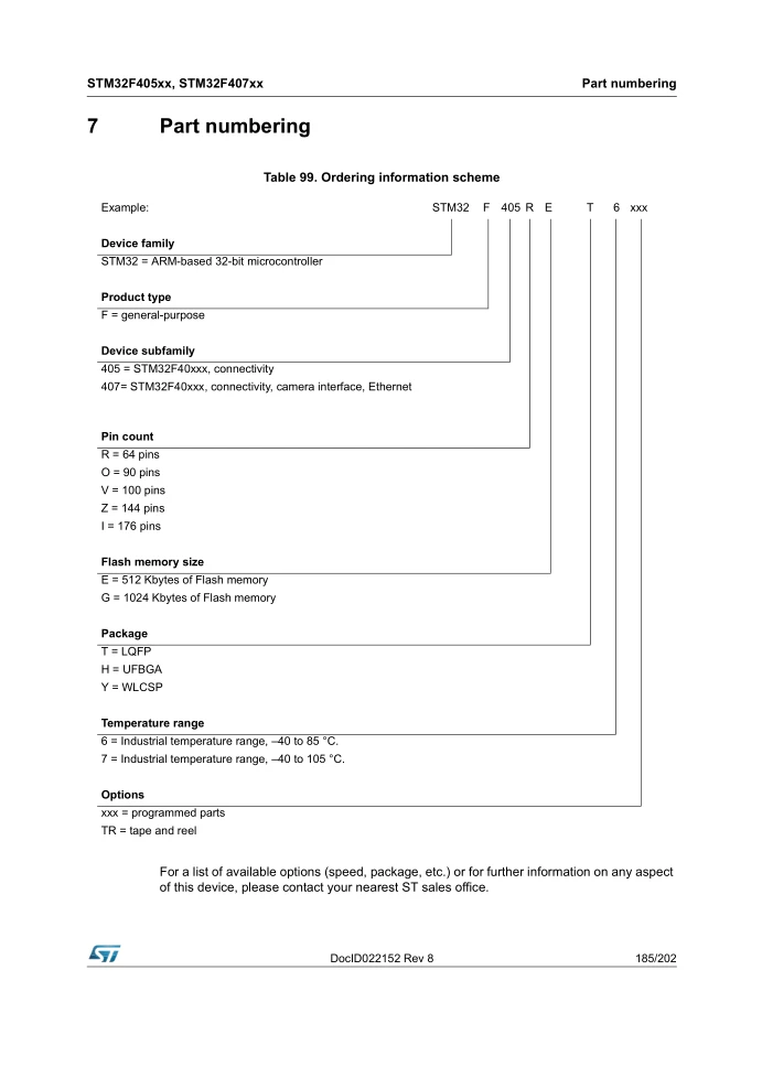

What 's the meaning of the last letters in the device name?
STM32 devices names end with: VGTx, VGHx, RETx, REYx.
The first 2 seem to be associated with memory size and the last 2 to the package. Is there any logic to it and is there any document describing it?
waclawek.jan
waclawek.janBest answer
July 2, 2019
Any STM32 datasheet:0690X000009YJUsQAO.png

ricardomiguel
July 2, 2019
Thanks, missed that :\
