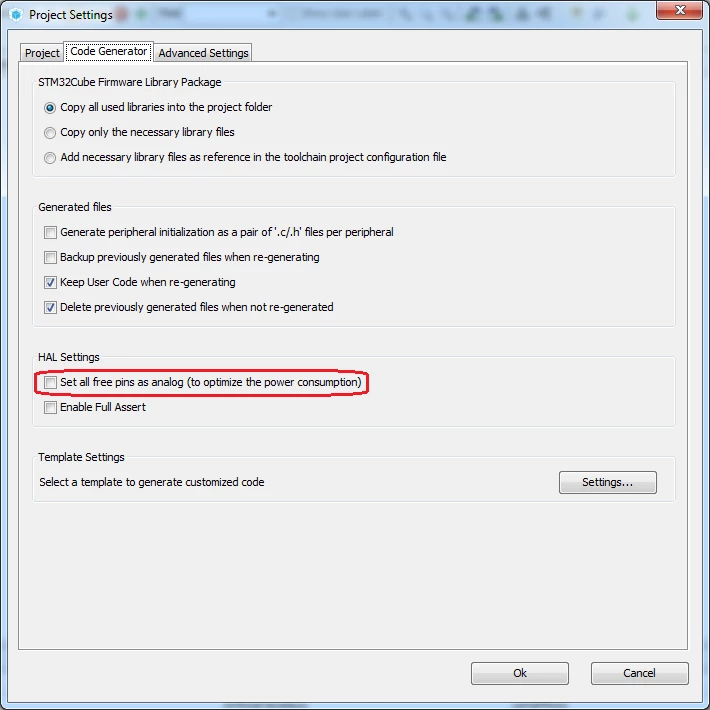

    for this answer. On the top of what you said I would like to add that switching off GPIO's Schmitt trigger also decreases a bit current consumption of MCU. That is why Analog Input is a recommended mode for all GPIOs, which are unused by application.
    Analog Input is a default mode of GPIOs inlow-power STM32 MCUs: STM32L0 and STM32L4. For other STM32 familiesuser has to take care about configuring unused GPIOs in Analog Input mode. This task can be easily done with STM32CubeMX:
