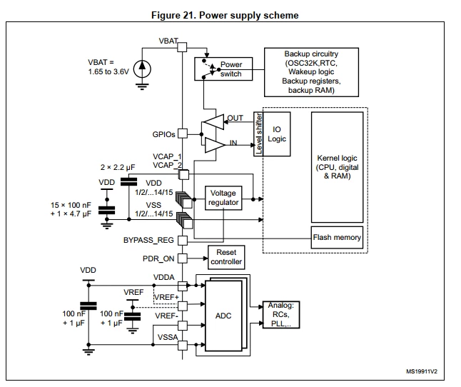

For the scene without serial resistor, another question is whether there is no damage if VBAT is always present even VDD is not present? For the picture below, it seems the I/O part works with only VBAT. Am I correct?

gbm
June 22, 2022
What makes you think that? From the picture, it is clear that VBAT powers RTC and backup RAM only, and only when Vdd is not present.

Yang Yang
Yang YangAuthor
June 22, 2022
Hello, gdm
Yes you are right. I do not see it clearly.
