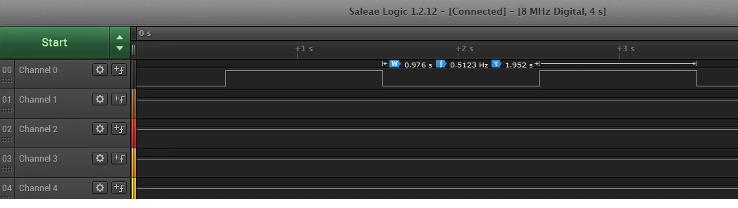

I am using TIM6 to generate 1 sec of delay and i am toggling LED gpio in the timer ISR
HCLK is 50MHz , prescalar = 999, and period = 49999
The issue is when i use below macro, i get close to 1sec. shown in the pic below
__HAL_PWR_VOLTAGESCALING_CONFIG(PWR_REGULATOR_VOLTAGE_SCALE3);
and when the that macro is not used. there is a significant difference . I want to know how exactly that macro is affecting here. i can not able to connect the dots. please help

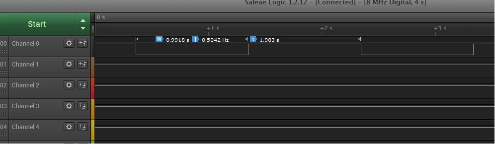

without above macro output

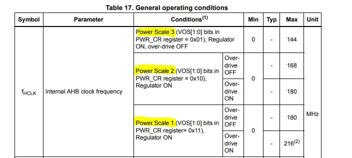

    Hi
    balckiran
    The voltage scaling allows optimizing the power consumption when the device is clocked below the maximum system frequency.
    for more details please refer toPower controller (PWR) chapter , Voltage regulator paragraph in you reference manual and General operating conditions in your datasheet :
    STM32F7 datasheet example:
    -Nesrine-

    Very sorry , that doesnt answer my question . I want to know why i see difference in timing when scale 3 is used . Thank you .
