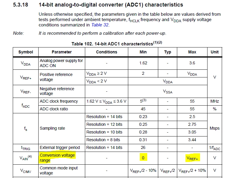

On STM32U5 devices there is supposed to be no Voffest on the ADC1.
As indicated in the datasheet section 5.3.18 "14-bit analog-to-digital converter (ADC1) characteristics" if your VREF- is connected to VSSA and to the ground, the conversion voltage range for ADC1 is VSSA (0V) ≤ VAIN ≤ VREF+
Please find in attached the datasheet.

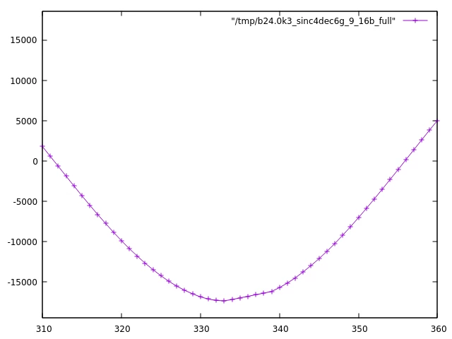

Below 15mV it's not linear anymore. That's what I get from my measurements. My setup is:
  1. Generate a sine wave using DAC1 on PA4 from 0 to full scalb24_0k3_sinc4dec6g_9_16b_full(in my case 1.5V after modifying the B-U585I-IOT02A)
  2. Sample it back on ADC1
  3. Filter it
  4. Plot the result

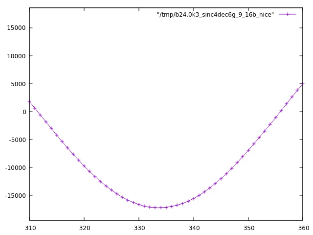

0693W00000SvyRcQAJ.pngAs you can see, it is not a perfect sine wave, it has an "indentation" when the input signal is close to 0V. In contrast, if I limit it to 15mV, I get
0693W00000SvySQQAZ.pnga nice sine curve.

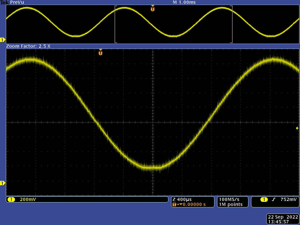

September 22, 2022
Thank you for your response.
Can you try to observe directly the DAC1 output with an oscilloscope ?
If the issue is coming from the DAC1 you will be able to observe the same behavior.

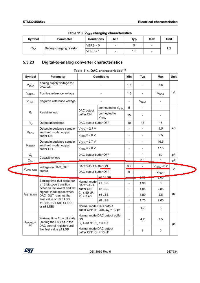

waclawek.jan
September 22, 2022
In the gory details, you've forgotten to mention whether you use the DAC buffer or not. That buffer is known not to go rail-to-rail in the STM32.

I use the buffer, looks like the 0.2V is a rather conservative estimate.

September 22, 2022
In my setup, it DAC1 on PA4 does reach rail. Difference from 1.5 is < 5mV. Only the lowest 10 values or so are saturated.
