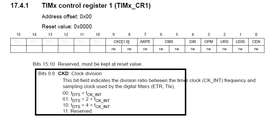

What is the use of Clock Division settings ?
Posted on June 15, 2018 at 10:00
Hello, I am using TIM2 peripheral and many times f(DTS) is mentioned , what is that ?
also what is the purpose of clock division settings ?
does it divide the internal clock ? (CLK_INT)

The ETR input and the channel's inputs have digital ('de-glitch') filters on them. The input clock to these filters may be a divided version of the timer's internal clock (i.e. the one which arrives from RCC); and this field determines the division ratio for those.

Thanks for your reply . makes sense now .
