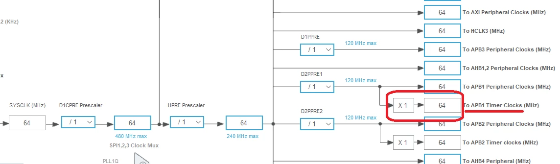

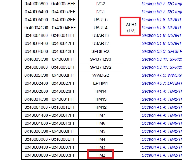

What is the timer clock frequency for STM32H755 chip ?
What is the frequency of timer2 which is of 32  bit with prescaler value 0 for NUCLEO-H755 board and how to check it ?

TIM2 kernel clock is generated from APB1:
From the reference manual:
In CubeMx:
That clock is devided with the timer prescaler

You can check the clock and prescaler in STM32CubeIDE.

Thank you soo much

Divide it down and have in Toggle mode one of the TIMx_CHx pins associated with it.and measure it on a scope?
The clock tree should be usable to determine the base frequency.
