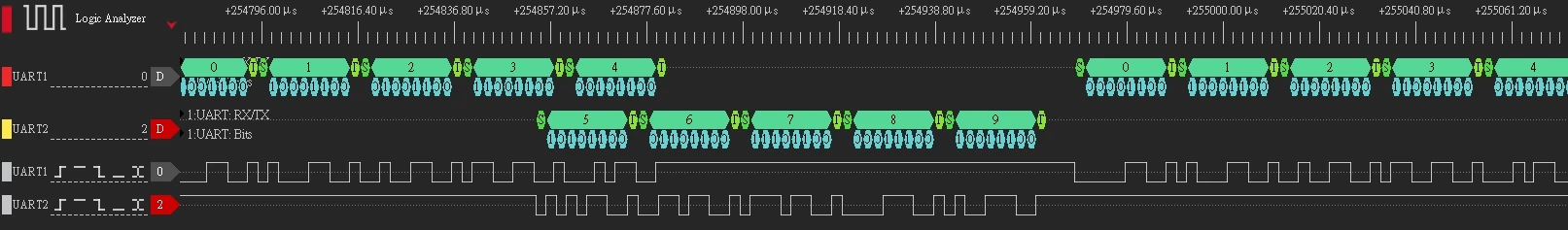

You're right, I originally used HAL_UART_Transmit() so the UART1 and UART2 can't work at the same time, as below

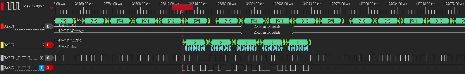

So I just wrote a testing code to check for UART1 and UART2 work simultaneously, using HAL_UART_Transmit_IT(), and i got the result as below
As you can see, the UART1 and UART2 can work together, however the data of UART1 are totally broken, I have no idea why.

No clear idea of what is the problem. Only some ideas to help investigating ...
1 - during first sending on USART1, are 0,1,2,3,4 chars properly sent ?
2 - If you break in your debugger, while erroneous transmissions are ongoing, could you check content of UART1Tx buffer (to check it still contains 0,1,2,3,4) ?
3 - could you give a try to check what happens when USART2 Tx is disabled (comment HAL_UART_Transmit_IT() call in HAL_TIM_PeriodElapsedCallback) ?
