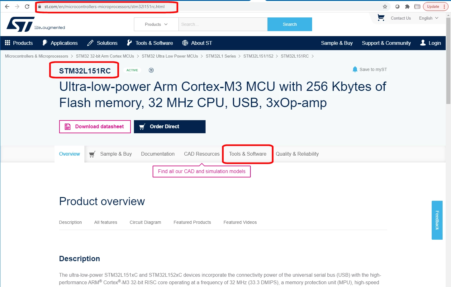

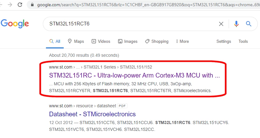

The standard approach for any microcontroller is to start at the manufacturer's Product Page for it - you can find that easily by simply putting the part number into google:
For an ST product, it looks like this:

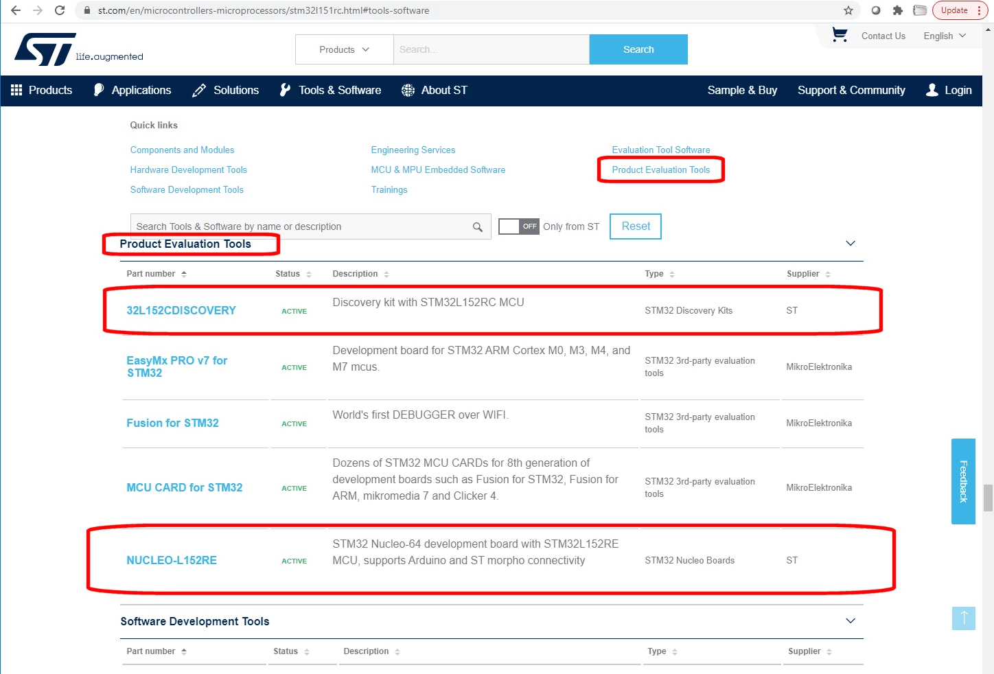

Go to the 'Tools and Software' Tab; scroll down (or use the "Quick Link") to 'Product Evaluation Tools' - there you'll see the recommended evaluation boards:
0693W000007ZTowQAG.pngWhile you're on the Product Page, take time to browse through the 'Documentation' section

Hi MBhir.1,
the NUCLEO-L152RE board has the functionality to evaluate the STM32L151RCT6.
It contains an STM32L152RET6 which has a built-in LCD controller and more memory than the 'L151RC, but you don't have to use the additional features.
I've used this board for many times, and I think it will fit your needs.

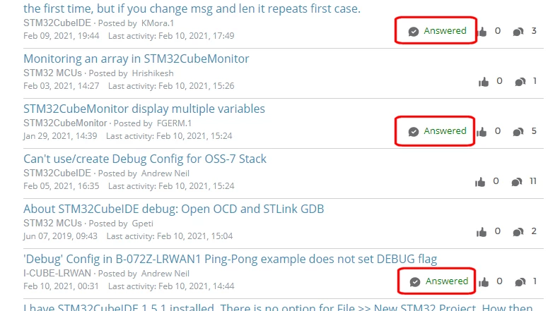

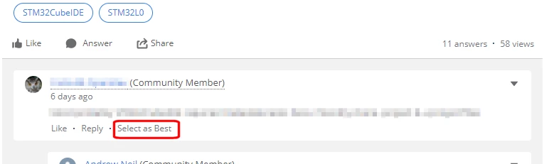

If your question is now resolved, please pick a 'Best Answer' to flag that:
Then this will be flagged in the topic listing - so others can see it's answered:
