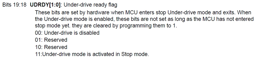

What is the right sequence to enable under-drive mode in STM32F779NI ?
I'm not able to enable MR under-drive mode in my STM32F779NI chip.
The exact problem is UDRDY is not getting set -> Line number 39 to 43.
Below is the code snippet. Any suggestion would be very helpful. Thanks in advance.

	while( ! ((READ_BIT(PWR->CSR1, PWR_CSR1_UDRDY)) == PWR_CSR1_UDRDY ) );

It looks like UDRDY bits get set only when the CPU enters stop mode. You can check for and clear them after it wakes back up.

Sorry. I overlooked this information. Thanks a lot ! :)
