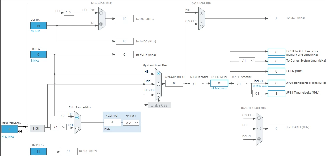

Note that systick is 24-bit. And with 8 MHz systick clock, 8000 = 1 ms. One second (0x7A1200) _should_ fit, though.
You should cast the 64-bit uint to 32-bit before writing it into the reload register.

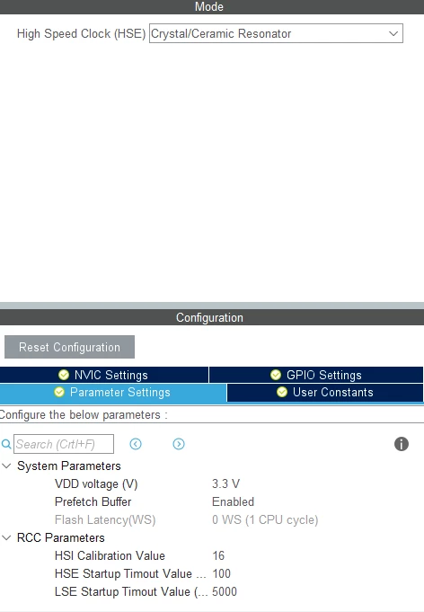

Maybe you should check from the generated code, that the clocks ate, indeed, set up the way the picture shows. Especially check the systick clock divisor selection bit.
I recall that bit defines whether the systick runs in the bus clock speed or if the clock is divided by 8. At least Atollic debugger shows the HW registers.
ahmetgunduz
ahmetgunduzAuthorBest answer
Oct 18, 2019 9:21 AM UTC
thank you now it works fine. i added these.
SysTick->CTRL &= ~SYSTICK_CLKSOURCE_HCLK_DIV8;
SysTick->CTRL |= SYSTICK_CLKSOURCE_HCLK;
