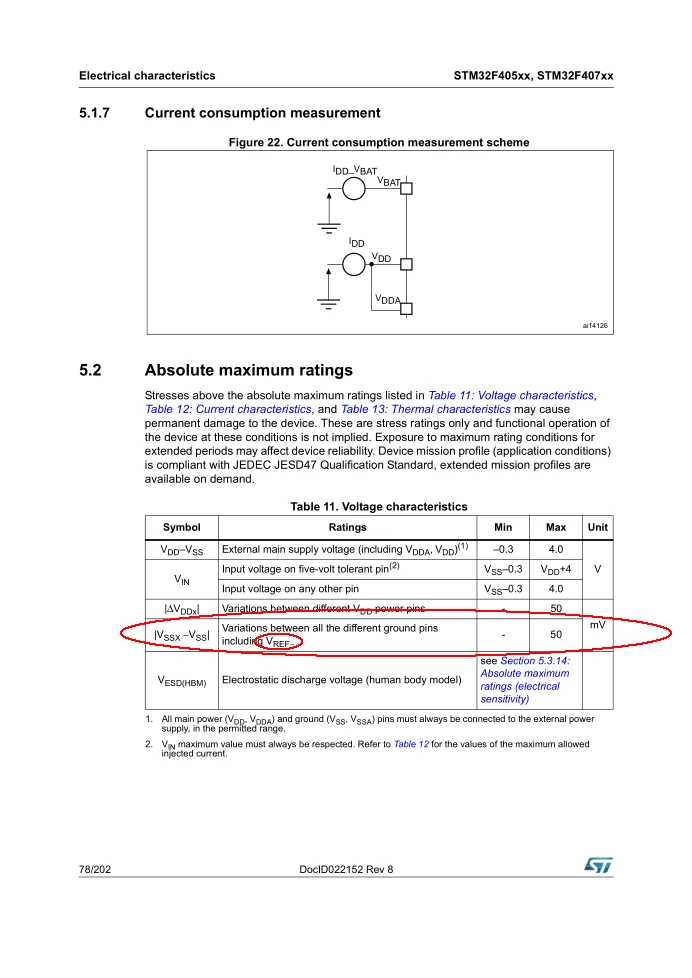

What is the Maximum 'VREF-' for ADC section?

You'll find it in the datasheet for your particular STM32 model, but basically VREF- should be tied to GND, e.g.:

LPola
LPolaAuthor
Sep 13, 2019 1:22 PM UTC
Thank you so much
