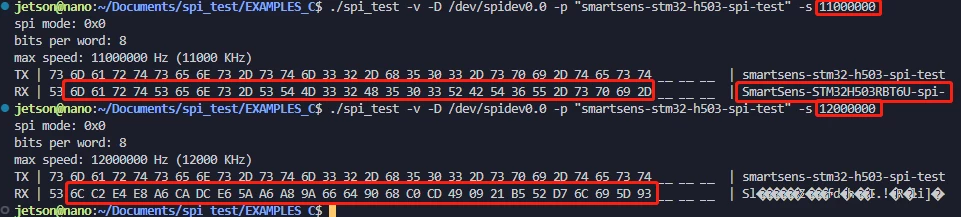

I use spi1 as the slave to receive data, and if the speed of the spi master is set above 11M, the data received will be misaligned.I would like to know what is the maximum speed supported by the SPI peripheral on the stm32h503rbt6u chip in the slave mode?

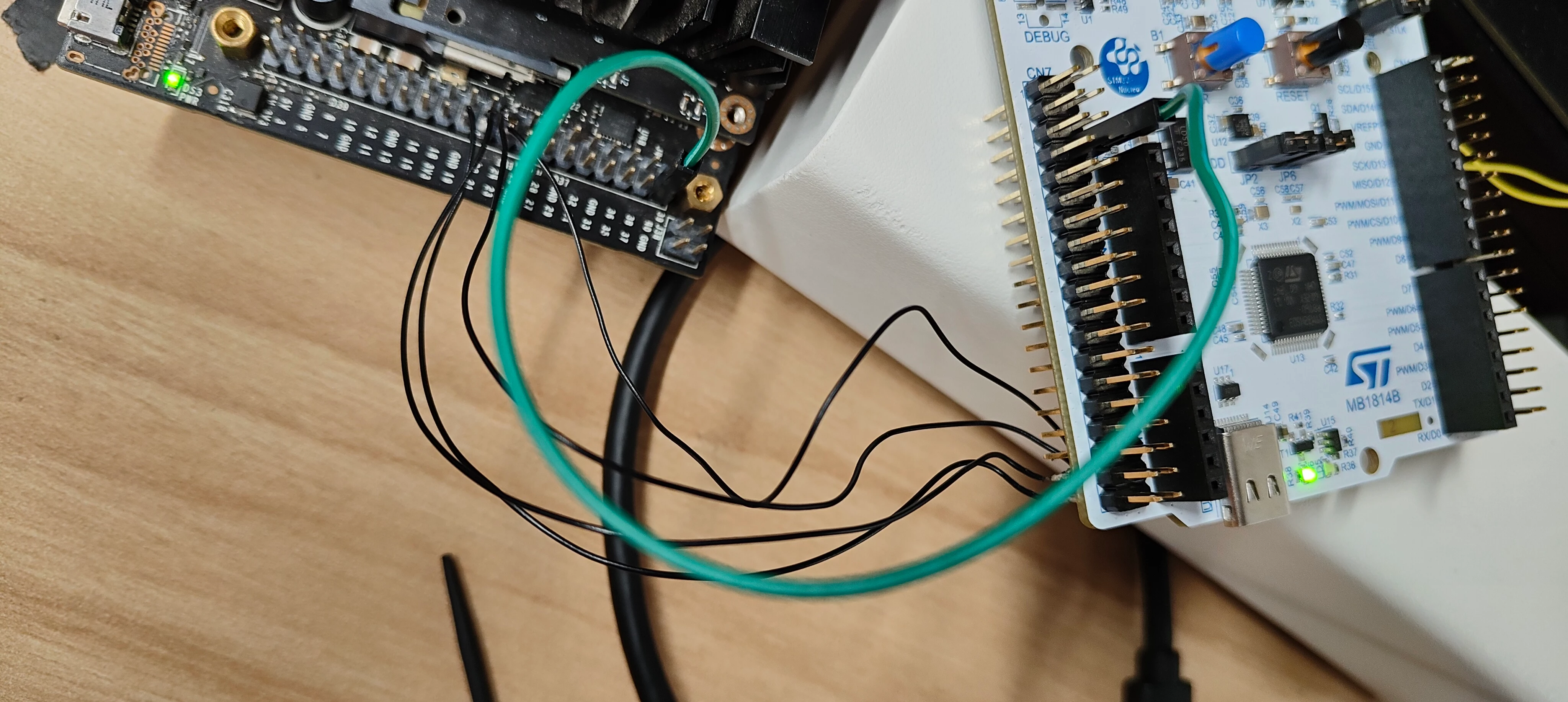

How does the physical connection look like? Can you show photos?
What are the logic levels at both sides?
Is NSS low all the time during transmission?

As shown in the above figure, when the speed set by the spi master exceeds 11M, the data sent by the slave appears to have lost bits

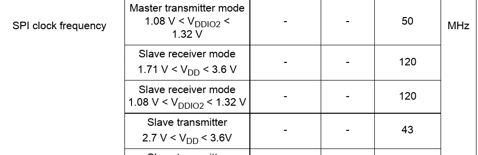

from ds :
so 120MHz max.   ; how long are the wires ? ground /shield ? damping resistors ?

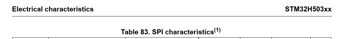

May I ask which document should I refer to for this image? I am using a DuPont cable, and the master and slave devices use the same ground
AScha.3
June 26, 2023
cpu data...

The physical connection is shown in the figure above.
The logic level is all 3.3v.

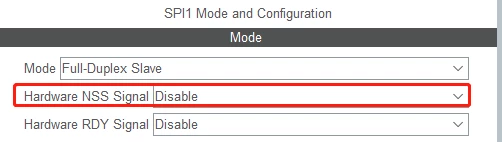

NSS has always been low, but it is not used in firmware

Read the article I linked to.
12MHz is not a trivial frequency.
