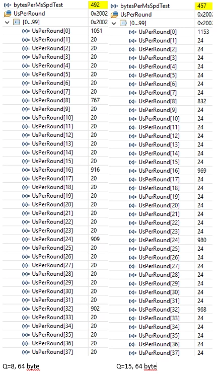

Hi all,
I am trying to get a hight speed write to SD via SDIO as well. I use a project generated with Cube MX, 4bit SDIO and DMA. But I only get a write speed of about 300 kBytes/s. I write 1000 times a 100 byte block, because I need a write about every 100 us. With a 100 byte block I have a write time of about 25 us, but every fifth time over 1 ms. Weird...The time span to the 1 ms write decreases the less bytes I write.

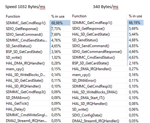

When I look at the trace of TrueStudio, I see that more than 60% of the time is spend in the function SDMMC_GetCmdResp1, compared to only 0.05% in BSP_SD_WriteBlocks_DMA... (Screenshot attached)

I have tried another example from the CubeLib V1.16/Projects/STM324xx9I_EVAL/Applications/FatFs/FatFs_uSD, copied the write loop from the previous project and had a write speed of about 1 MByte/s - yesterday. Today I tried to compile it with optimize level 2 and now I have the same write speed like in the previous project, of about 300kByte/s. This is weird.
