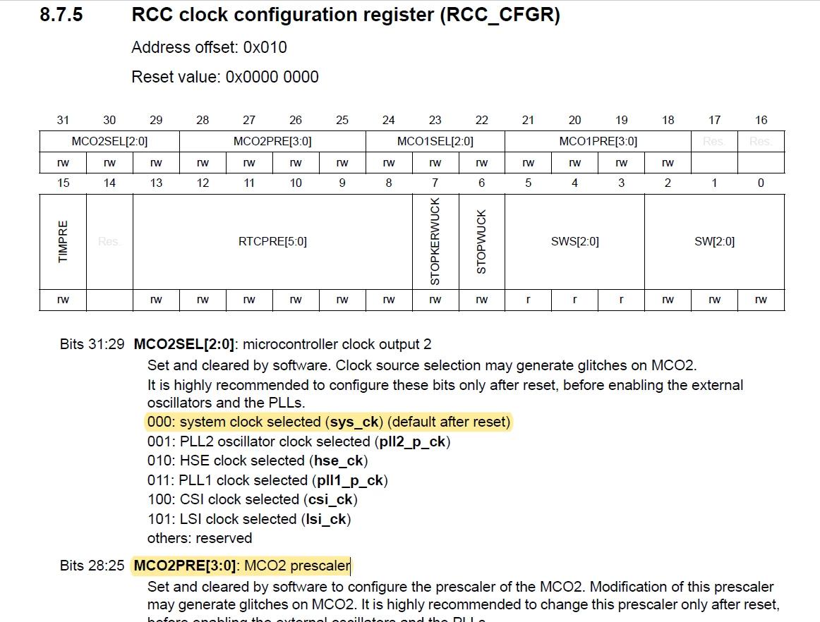

You can use MCO2 to output an image of the system clock:
0693W00000LvUFEQA3.pngSelect a prescaler value in a such way to not exceed 100MHz.

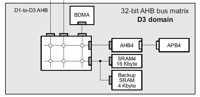

0693W00000HnhZeQAJ.jpgBit banging the GPIO on the H7 is a lot slower than other STM32, parked off of AHB4/APB4.
Ditto driving with DMA and Pattern Buffers.
