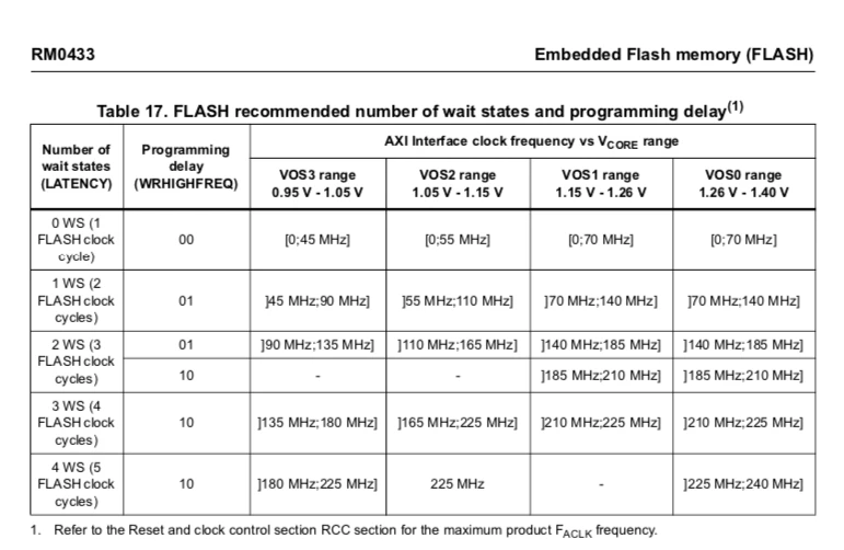

What is the maximum Flash clock freqency of STM32H743?
  • April 17, 2020
  • 5 replies
  • 1479 views
Is it possible to drive the controller with 480 MHz and therefor the flash with 240 MHz?
How many waitstates have to be set at 240 MHz?

Look for FLASH recommended number of wait states in the reference manual.

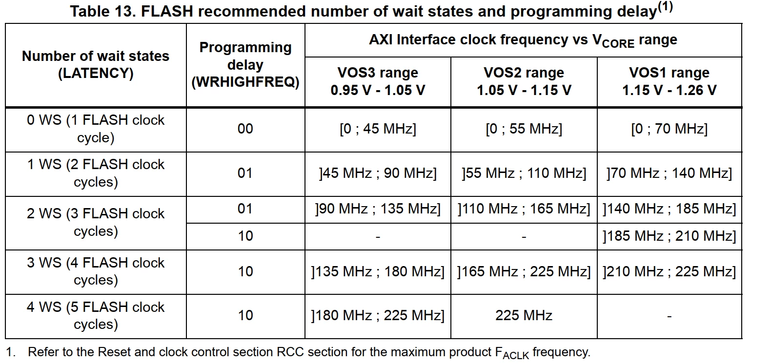

In Table 13 in reference manual (DS12110 Rev 7) the maximum frequency is 225 MHz (see attachment). But in Comment (1) there is a reference to the maximum product Faclk frequency (240 MHz).
If I config the Faclk freqency to 240 MHz in the STM32CubeMx there is no error and the controller is running well.
Danish1
Lead III
April 17, 2020
Can you double-check you're looking at the right document.
For stm32H743, the Reference Manual is RM0433 for "STM32H742, STM32H743/753 and STM32H750 Value line
advanced Arm®-based 32-bit MCUs"
And that states in Table 17 that you need to be in VOS0 to go to 240 MHz.
berendi
Principal
April 17, 2020
and Revision 7 dated Feb 27, 2020
roland23
roland23Author
April 17, 2020
Thank you. I've got the wrong version :face_with_tears_of_joy:
