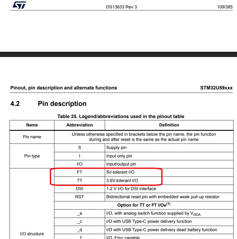

What is the differences between TT and FT mode for usb pins PA12&PA11 in STM32U595?
Hello, ST expert
For GPIO structure, what are the differences between FT and TT mode? Are there any differences for the ESD diode and the other diode in these two modes?

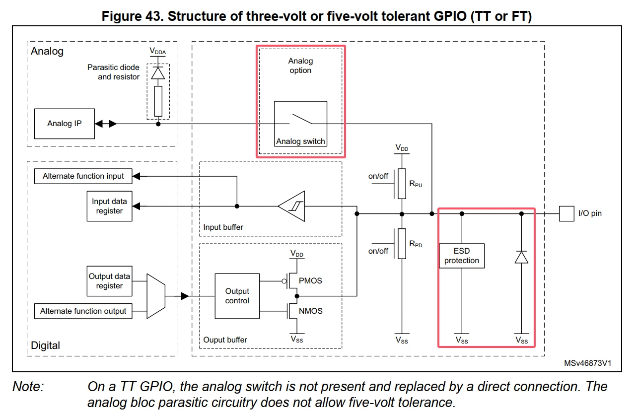

Hello, Neil
I know what FT and TT means. The question is what are the differences in the GPIO structure in these two modes? e.g. the state of analog switch in the graph? or any other difference?
The graphic you posted says that there is no analogue switch in TT

Hi @Yang Yang
TT pins have clamping diodes to VDD limiting voltage tolerance to VDD + 0.3V. However, FT can tolerate 5V in input/open drain mode without internal pull-up/pull-down.

Hello, FBL
Does that mean there are not any differences about the internal ESD diode and the other diode(circled in the first graph) in these two modes?
BR
Yang
FBLBest answer
May 20, 2026 10:29 AM UTC
Hi @Yang Yang
OK it depends on the product, I assume in your case TT pins have clamping diodes to VDD limiting voltage tolerance to VDD + 0.3V used for ESD discharge protection.
The second diode provides a low impedance path to ground when the GPIO voltage goes below VSS.
Regarding the exact internal implementation of ESD protection in FT differs and I can't provide more details. All needed info are provided in AN4899 section 5.2.
To answer your question, > does FT mode shows better endurance than TT mode in ESD spike?
FT refers mainly to 5V tolerance, while ESD robustness depends on the specific pad design and the product’s ESD ratings, not simply on whether the pin is FT or TT.
