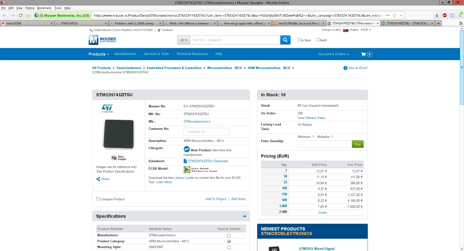

What is the difference between STM32H743ZIT6 and STM32H743ZIT6U?

    As the data sheet tells:
    For a list of available options (speed, package, etc.) or for further information on any aspect
    of this device, please contact your nearest ST sales office.
    Perhaps the 'u" means tray?
    waclawek.jan
    November 1, 2019
    From UM1974:
    This board features a specific STM32 device version which allows the operation of any
    stack or library. This STM32 device shows a "U" marking option at the end of the standard
    part number and is not available for sales.
    Strangely enough, these parts *are* available at the distributors, and there is stock, e.g.
    See also
    https://community.st.com/s/question/0D50X0000BMFXhu/here-we-go-again-with-suffixed-parts-stm32g474ret6u
