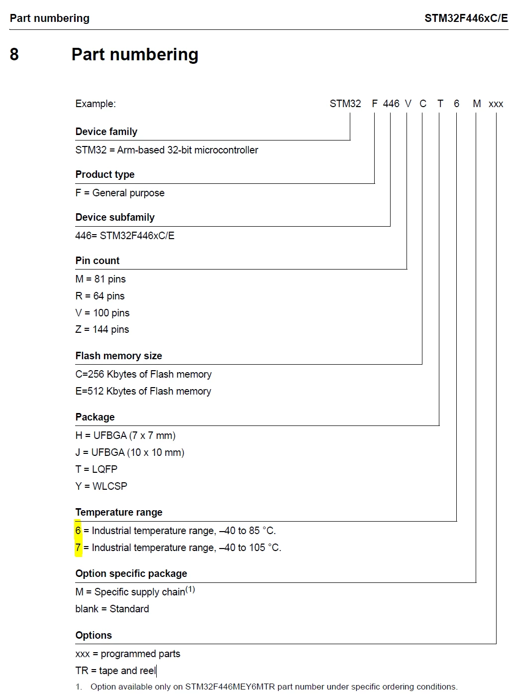

What is the difference between STM32F446RET6 and STM32F446RET7?
Is there any documentation on the differences? Are these two part numbers functionally identical?
TDKBest answer
May 8, 2021 1:35 AM UTC
They have different temperature ranges.
The datasheet describes the part numbering scheme.
