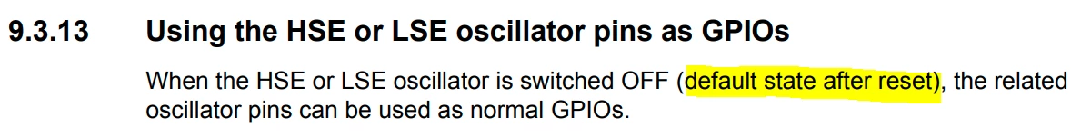

The as-reset behavior is outline in the reference manual. The chip is always clocked from the internal HSI MSI after reset, not from HSE.
Per the reference manual, the HSE is off after reset and the PH0/PH1 pins can be used as normal GPIO. Per the reference manual, they are configured in high-impedance analog mode after reset (see MODER register). They are not driving NRST low. Look elsewhere for the answer to your issue.

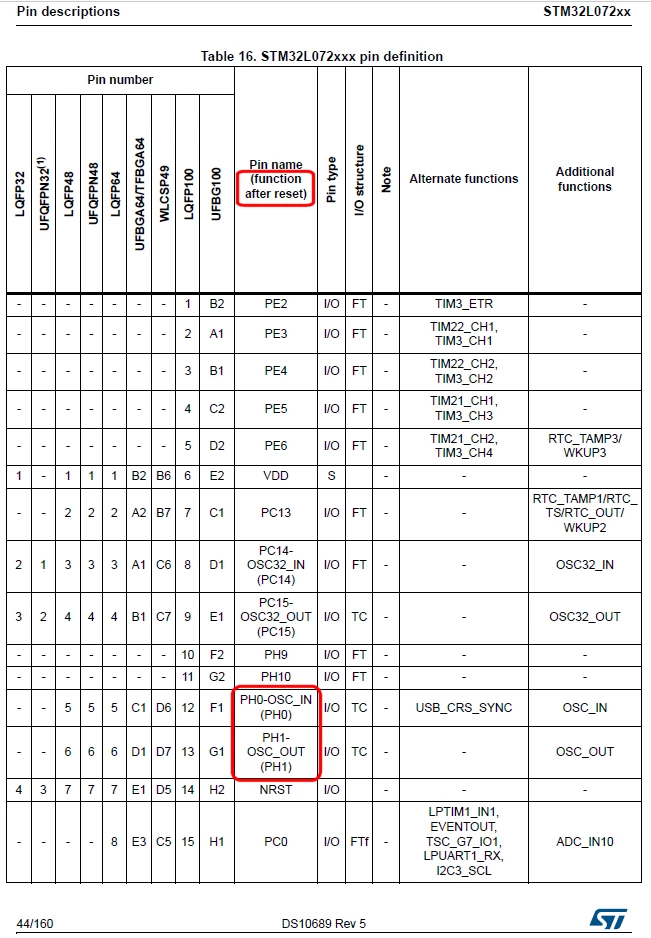

Andrew Neil
May 4, 2022
Also in the Datasheet:
