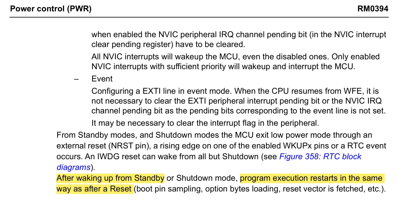

What is the cpu state when exiting standby mode
When the MCU is placed in Standby Mode, where does the CPU begin to execute when exiting the mode? (for example, on an RTC event)  Is it a reset or a return from interrupt?  RM0394 isn't clear on this.
TDKBest answer
September 9, 2025
It resets when exiting from standby.
RM0394 says it here:

TDKBest answer
September 9, 2025

Thanks!  Maybe I should have searched for the word "execution"!
