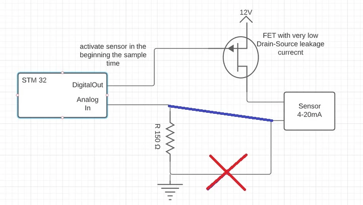

What is the best way to read sensors to sample 4-20mA sensor with STM32L476RGT6
Hello STM Community!
First of all, I would like to thank you to read my topic and enter in this discussion.
I'm new with STM32, and it's the first project of mine that I really need to worry about energy comsuption.
In my project I have sensor that Input =12V and output 4~20mA.
I waas think to use something like figure below.
However, I don't think is the best way to do when power consumption it's something relevant.
So, with you guys have better suggestion I would aprreciate!

0693W000005BQxzQAG.jpgNeed to correct schematic.
You will have voltage in range from 150Om* 4mA = 0.6V to 150 Om* 20mA =3V.
Also need for fet`s driver.

Thank you alexKeisy.
I didn't notice that mistake.
However, coul you tell me if this kind approach it's the best one?
(Obs: thank you for the fet's tip ).

This schematic is usable for short distance`s tens of meters, maybe hunderd`s and low electromagnetic noise. I don`t know best way or not :) thats correspond for usage. Maybe it`s need for higer voltage power source, because some value (0.6-3V) drop on the resistor-refer to the sensor documentation. Also ESD protection is very important.
