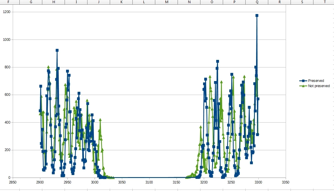

I have successfully configured the adc watchdog. But i am a bit dissapointed of the accuracy. I set the bounds to 1000 and 3000, but when i read the values of the adc from the watchdog interrupt, i get also values from within the window (up to 1025/2975).
The signal is 10Hz Triangular. I already measured the time from beeing outside of the window until the interrupt is executed (4us). So there is no timing issue.
In the manual it says:
The analog watchdog feature allows very precise monitoring of the converted voltage of one, some or all selected channels. An interrupt is generated when the converted voltage is outside the programmed thresholds.
25 of 4096 at 3.3V is 20mV... I would not call that very precise, not even precise....
Is it a safety margin?
I could compensate this, but i wonder if it could change somehow (temperature etc.)?

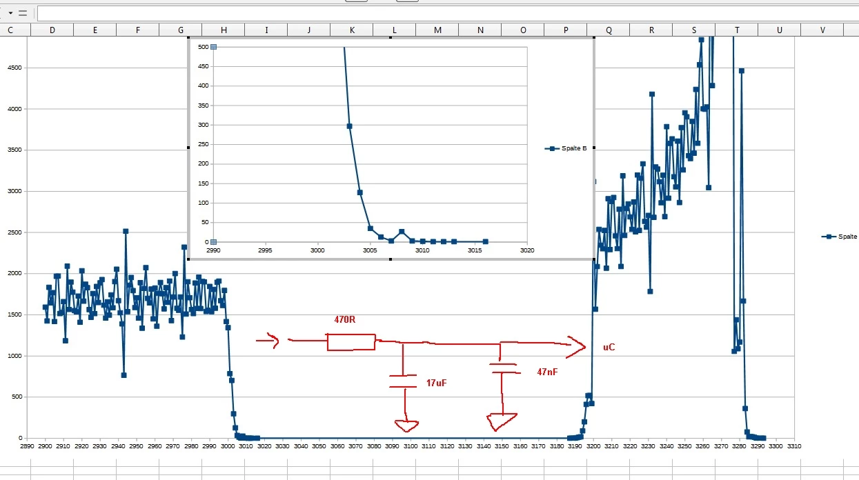

I made a diagram, to visualize it and added a cap to smooth out the signal:
_legacyfs_online_stmicro_images_0693W00000bijYFQAY.png x-axis shows the value from the ADC, and the y-axis is the number of measures values. The window has been changed to 3000/3200.

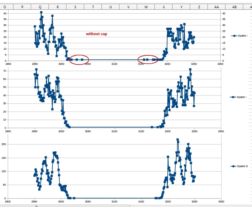

I could now improve my measurements a tiny bit. As i did forget about my signal i used, there were some artifacts (valleys and mountains in the signal). Those came from the DAC that was generating the signal.
But still the values when the watchdog fires are not precise. My test setup is on a breadboard. The increasing numbers to the right are, because the signal curve flattens at higher level, and produces more measured values. The signal is a 2Hz triangular (somewhat) waveform.
waclawek.jan
April 25, 2023
The watchdog is digital, so its accuracy is the same as any ADC readout.
I don't know how do you determine the value in the interrupt, but if the latency is too high and you have continuous conversions, you may read out not the value which triggered the interrupt, but value from some subsequent conversion.

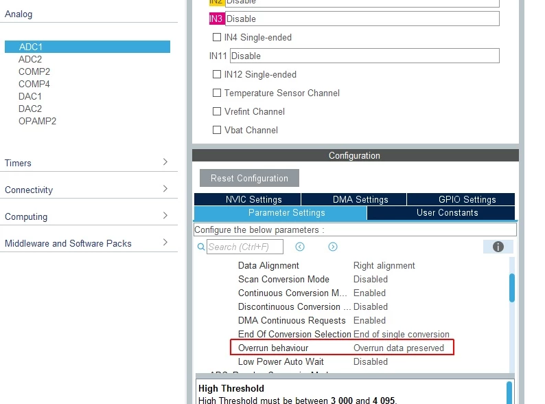

No, i have set the option to preserve the data in the register. I thought "well thats it" but i was quite dissapointed as it didnt change much. Or maybe there is more to it?
That has nothing to do with the watchdog. That setting means, that in case of overflow (i.e. if new conversion finishes and previous conversion's data have not been read) the new conversion's data are not thrown away, but replace the old data.
You not only don't read the value which caused the interrupt, by adding deliberate delay in the ISR you more-less make sure you read an entirely different data, converted much later than the data which caused the interrupt.
