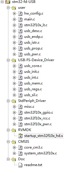

Hi all,
Thanks in advance for your time spent on this topic.
I have spent several months on STM32 project, fine with software coding, but keep confusion on the startup file, which would appear in
almost every project as below. I think everyone of you also should be very familiar with it.
I have spent time reading this code. It is like, I can understand every part of the code itself from grammar, but know nothing on big picture.
For example, I know it is the first code would be run after power on,it setup the stack, heap, interrupt entry address,
and then load main() function.
However, is there anything that I can play with it? Such as the stack and heap setup code below:
; Amount of memory (in bytes) allocated for Stack
; Tailor this value to your application needs
; <h> Stack Configuration
;   <o> Stack Size (in Bytes) <0x0-0xFFFFFFFF:8>
; </h>
Stack_Size      EQU     0x00000400
            AREA    STACK, NOINIT, READWRITE, ALIGN=3
Stack_Mem      SPACE   Stack_Size
__initial_sp
; <h> Heap Configuration
;   <o>  Heap Size (in Bytes) <0x0-0xFFFFFFFF:8>
; </h>
Heap_Size       EQU     0x00000200
             AREA    HEAP, NOINIT, READWRITE, ALIGN=3
__heap_base
Heap_Mem        SPACE   Heap_Size
__heap_limit
The code above set stack size to 0x00000400, heap size to 0x00000200, but why? Can I change it? Based on what criteria?
Is this .s code specified to MCU core or board level? Do I need to modify the code if I design a different board with different peripherals but with same MCU?
In other words, When, and how, must I make modifications to this .s startup file?
Thanks~~
