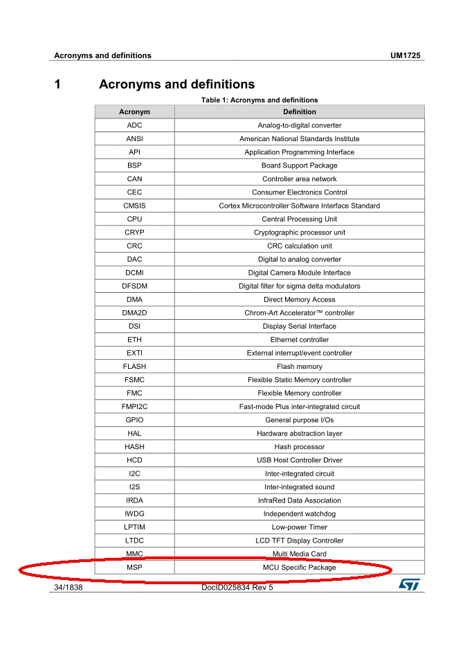

I am new to the STM32 product line and starting to write SPI code using the STM32cubeMX module. I note in the cube drivers manual that they provide both HAL_SPI_Init and HAL_SPI_Mspinit.  Looking through the web and also the source code I cannot figure out which to use nor what the ''MSP'' feature of STM's SPI is. Can someone enlighten me here?

    •Peripheral system level initialization/ de-Initialization callbacks : HAL_PPP_MspInit() / _DeInit() : Ex: HAL_SPI_MspInit() Called from HAL_PPP_Init() API function to perform peripheral system level initialization (GPIOs, clock, DMA, interrupt)
    •Initialization and de-initialization functions:HAL_PPP_Init(), HAL_PPP_DeInit():Ex: HAL_SPI_Init() this function initializes the peripheral and configures the low -level resources (clocks, GPIO, AF..)

    Sorry, but that does not answer the question WHAT the term ''MSP'' means in this context.

    Mixed Signal Processor
    Reported from "Description of STM32F4 HALand LLdrivers"[1]:
    The MspInit callback performs the low-level initialization related to the different additional hardware resources: RCC, GPIO, NVIC and DMA.
    [1] https://www.st.com/content/ccc/resource/technical/document/user_manual/2f/71/ba/b8/75/54/47/cf/DM00105879.pdf/files/DM00105879.pdf/jcr:content/translations/en.DM00105879.pdf
    waclawek.jan
    March 19, 2019
