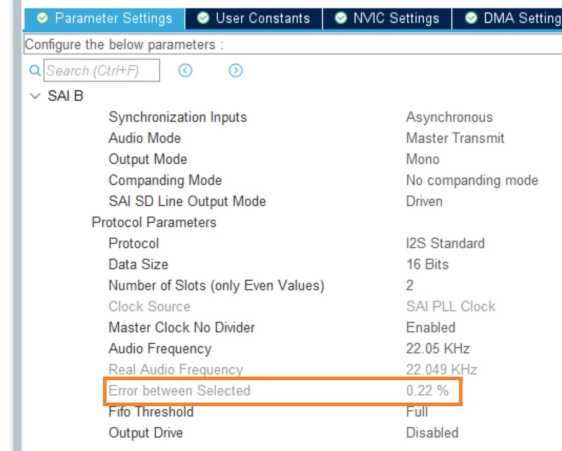

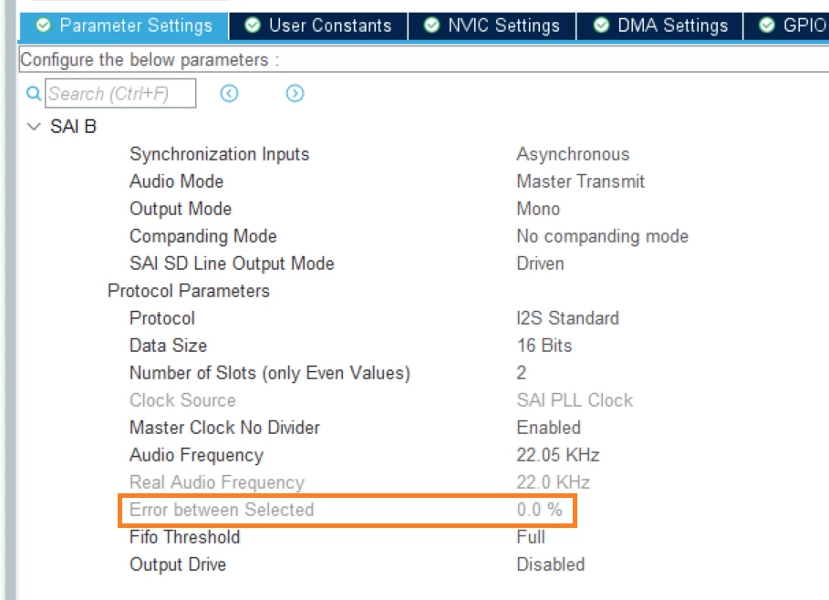

Today I spent some time to fine-tune SAI clock to get standard 22.05kHz sample output rate.
However, I do not understand why CubeMX states that "Error between selected" is 0.22%.
What is "Error between selected"? Why this error is zero when selected frequency actually differs from the desired value by 0.05kHz? Am I missing something?

Hello @TDJ,
Thank you for bringing this issue to our attention.
I confirm the issue and I reported internally.
Internal ticket number: 165344 (This is an internal tracking number and is not accessible or usable by customers).

@TDJ  , i can confirm: the % deviation is the cause of many a good laugh .
Whoever programmed this , has a big problem with with 3rd class mathematics. just laugh briefly and hope,
the calculated frequency is right. (which seems to be ok in my tests).

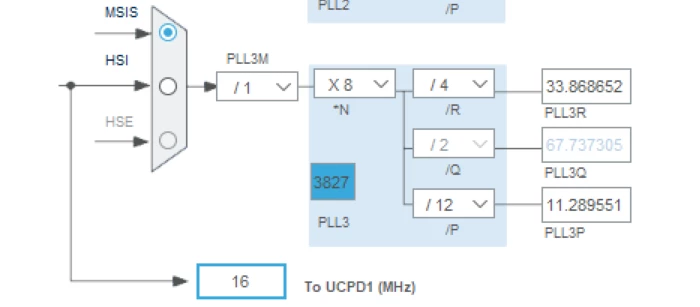

@AScha.3 I agree. Luckily, by fine-tuning PLL one can get really close and 0.001 HZ difference should no be audible even to musicians blessed with perfect pitch. That remains to be tested yet. Another approach I tried was using PLL 441x multiplier but I could not find settings within allowable frequency limits. So the current approach, that is, PLL3 clocked by 16MHz MSIS CRS-SYNCed with very stable LSE 32.768 kHz, may be the best one.

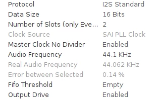

i (until now) never used the fractional setting in pll, because the jitter on the STM cpu is anyway not great, a cheap ESP8266 is better. And the fractional part...what could it do? switch the pll divider a step an back, in sigma/delta way. i cannot imagine, this will make a useful clock...did you check the jitter?
and for other dac, SAI in master transmit, i used:
with HSE 8M crystal , gives in Cube:
0,086% says my calculator. :)  (44100 / 44062 = 1,0008624) too difficult for STM software.
thats ok, so far.

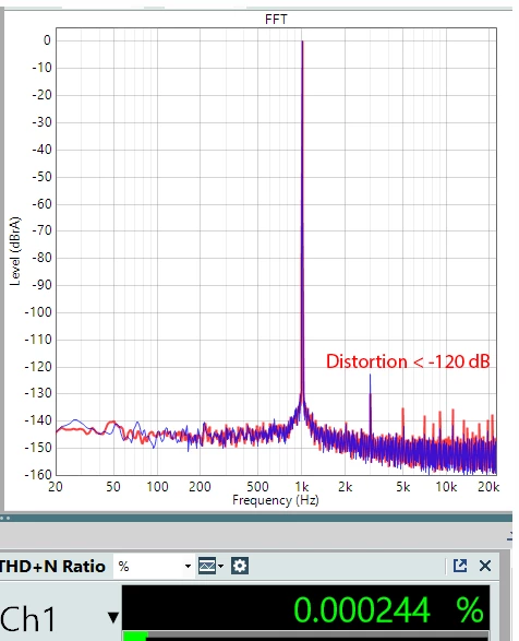

Concerning STM32 PLL and jitter:
I have used a few Nucleos (G4, F767, H723, with the ST-Link MCO as clock source) and a H735-DK and the PLL as source for SAI / I2S.
I have not seen any bad impact on signal quality, with TX-SPDIF and with 115dB SNR audio ADCs (sampling rate up to 200 kHz).
I think the jitter would have impact on non-oversampling ADCs.
