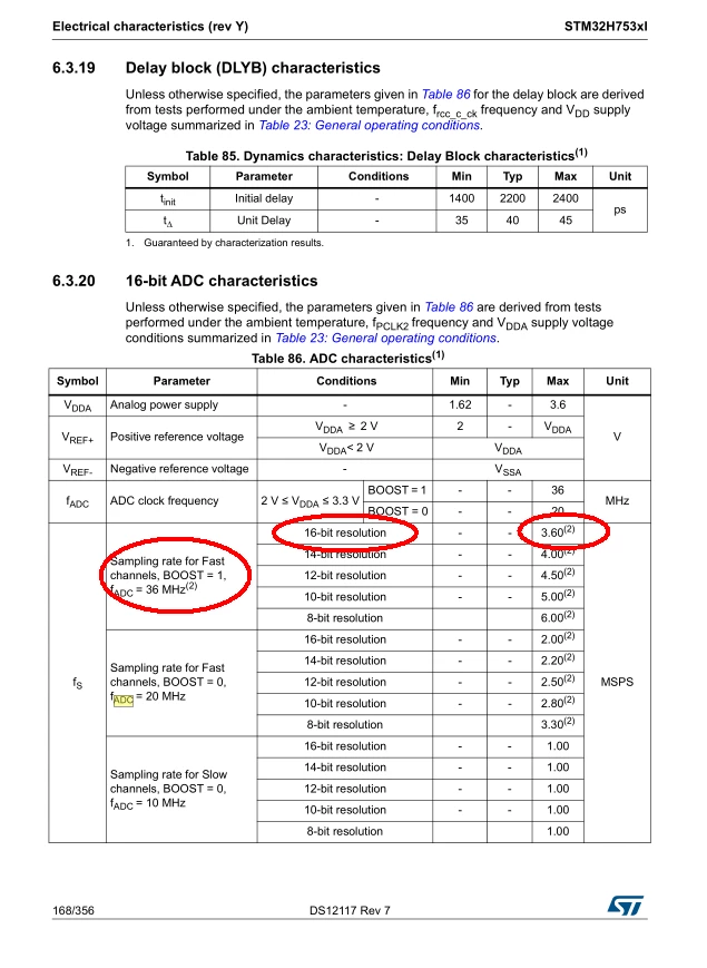

What is max sample rate settings of ADC-16-bit for stm32h753xx. I am getting 30000 samples/sec only.

0693W00000Bb1GwQAJ.pngJW
