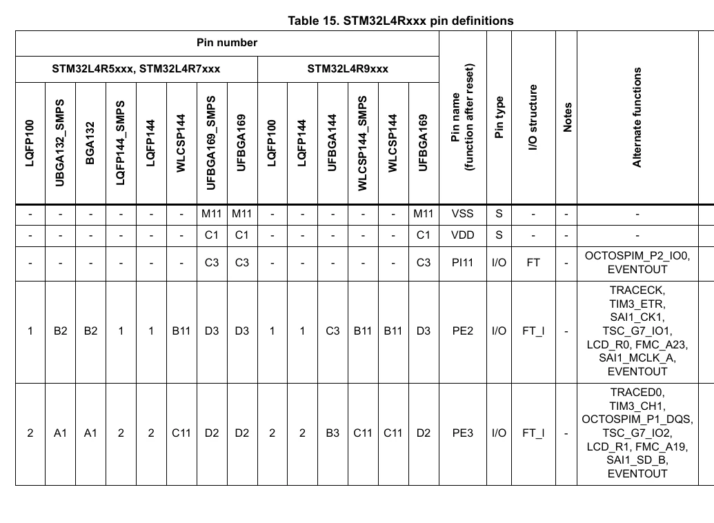

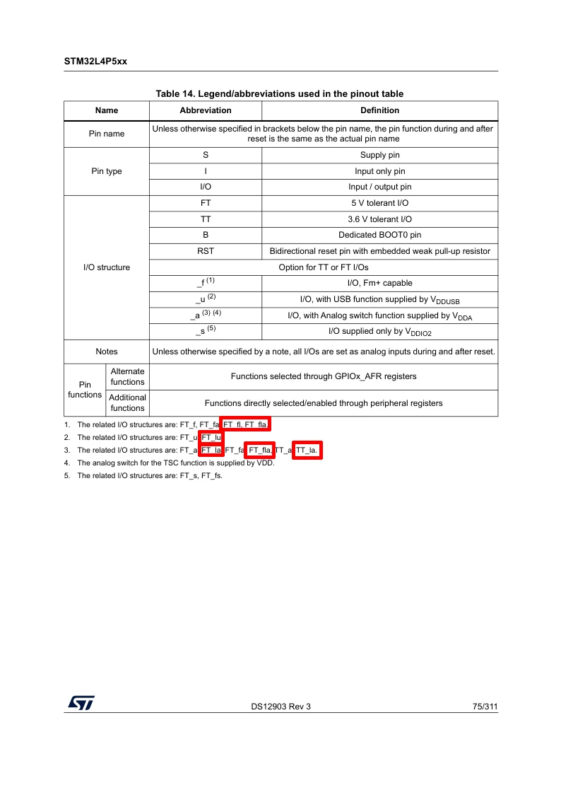

What is _l in pin IO structure?
In the STM32L4P5xx datasheet, some pins' IO structure is labelled with _l (in combination with other letters). However, this letter is not explained in Table 14 nor anywhere else.
Can this please be explained?

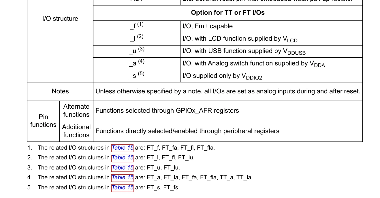

The pins' IO labelled with "_I" means the pin with LCD function supplied by VLCD supply.
I escalated this request (through internal ticket number 224978) to the relevant team to add this information in the impacted documentations.

The STM32L4P5xx does not have LCD controller (as in the segment-LCD controller - it does have LTDC, but those pins are normal CMOS outputs, not powered from a special power structure); and, relatedly, it does not have VLCD pin either.
Btw. I found VLCD references and also the _l suffix at various pins (even _l explained) in STM32L4R5xx, STM32L4R7xx and STM32L4R9xx datasheet (DS12023 Rev 5), too. Didn't check other L4+ models.

from ds L4Rx : ...same pin/functions
...and _l in table:
Needs correction in the ds L4P5 , i suppose.

As I've said, neither the 'L4Px nor 'L4Rx do have the LCD module, nor the VLCD pin.
IMO references to VLCD and the _l IO structure shour be removed from both datasheets (plus their crypto counterparts', if it's there too).

Hi @waclawek.jan
Good catch. I agree with your remark: STM32L4+ Datasheets declare VLCD or "VLCD" GPIOs while LCD is not present.
We will take the necessary action to full review and correct the content of the impacted datasheets.
