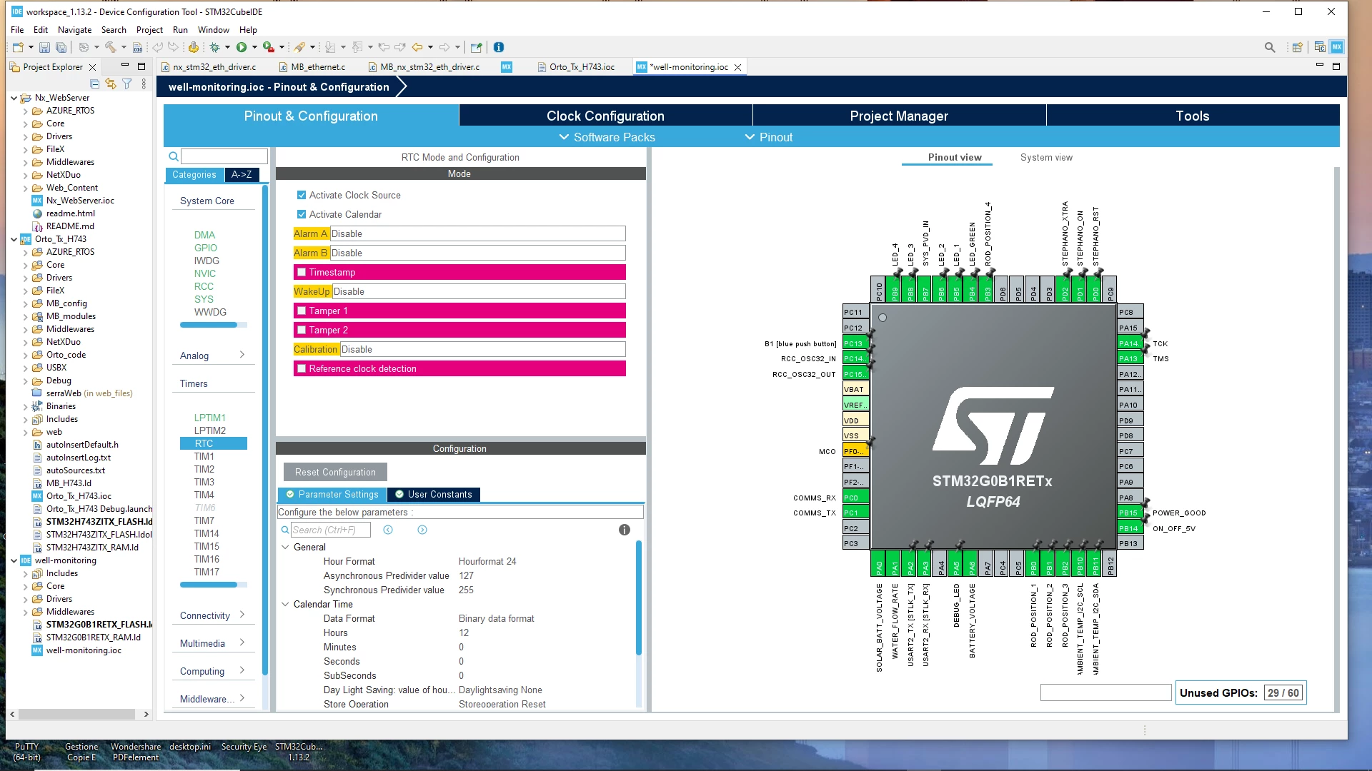

What is keeping me from enabling the RTC clock?
I want to the RTC to my project, but something is preventing the RTC clock from being enabled and I can't figure out what it is. IOC file is attached.

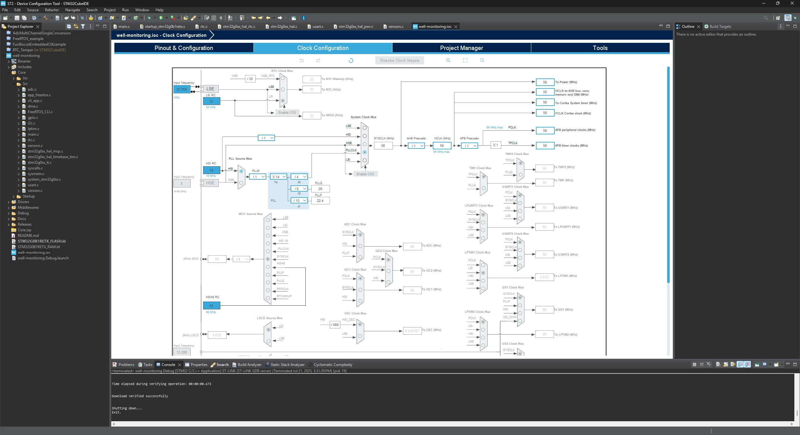

I seem to have fixed it myself. I reset the RCC configuration using the Reset Configuration button, enabled the RCC global interrupt, and changed to the Clock Configuration. I now got the pop-up dialog asking whether I wanted to allow clock issues to be resolved, which I did. I used the Resolve Clock Issue button and voila!, the RTC clock was enabled. SYSCLK was reduced to 32 MHz, but I might be able to live with that. After a successful test, I turned off the RCC global interrupt and the build continued to work.

I just created a new project from your .ioc and RTC is enabled !
Please mark as solved if you agree problem is solved.

Then why is it grayed out in the Clock Configuration view?
Senior
Jul 23, 2025 1:33 AM UTC
How can I fix my configuration so that the RTC clock is enabled without breaking my project?
