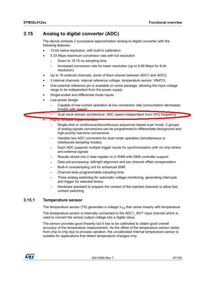

Hi all.
i using the ADC in STM32L412 MCU .
according to the DS , the current consumption of the ADC in Range 2 is 0.2uA/MHz for  independent clock domain and 1.8uA/MHz for  clock domain...
what is the "independent clock domain"
according to the DS , the ADC can run only at SYSCLK ( Figure 4. Clock tree )

I'd say, a copy/paste artefact from other 'L4 datasheets.
It decreases the credibility of the given value, though.
@Amel NASRI​  , can you please have a look at this?

Hi @Ach.1​  & @Community member​ ,
I am checking these inconsistencies internally, will come back to you on this regard.
