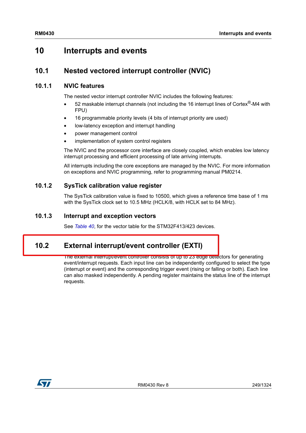

> Actually, EXTIT is the name of the external interrupt controller
Is it? In STM32 context, I've *never* seen it been called other than EXTI (no T):
That's why I'd strongly suggest to omit the T in the naming of enable bit, too.
