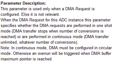

Xenon02Author
November 22, 2023
For DMA continuous request something like this :
Which is weird, in UART or other devices I didn't have to set this parameter, because if I set circular then in UART it would send data all the time or if I set DMA in normal mode it would send only once. But in ADC not only I have to set the DMA but also this DMA continuous request which is the same as saying that I am setting DMA two times to be Circular.
if DMA continuous request was disabled and DMA was in circular I wonder what would happen.
waclawek.jan
November 22, 2023
Yes, this is an unique feature of the ADC. I honestly don't know what's its intended purpose.
There would be no more requests (triggers) from ADC to DMA, even if conversions would continue. DMA would remain enabled but would not read converted data from ADC.
