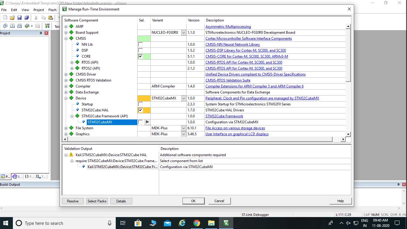

please clear one thing also to use HAL library in keil is it compulsory to use CubeMX. because when i create a project in keil and select device > startup or device > STM32CubeHAL it says configuration through cubemx is required. as shown in image

Aug 11, 2020 4:24 PM UTC
you don't need to make a new project in keil from scratch. cubemx generates all thing you need (source files, keil project file and ... ). It is the fastest way you can generate new project. Take a look on cubemx page in st website. there are very good documents to start.
