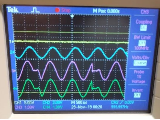

Now I also implemented the float32_t FIR example from CMSIS/DSP. I have verified, that the FIR filter works (amplitude shows low-pass characteristic). However I am seeing (and hearing) that the audio signal has gaps.
(blue: Input, 1Vpp, 1kHz. green/pink: Line Out L/R)
I suspect that this happens because I execute the FIR filter inside the DMA ISR - which is not the way to do it. The next step is to implement a buffering method to run the FIR-Filter not FFT (as in the comments) n the main loop.
How can this be achieved? What is good practice? Is there an app-note or a white paper explaining how to implement a buffer for this application?

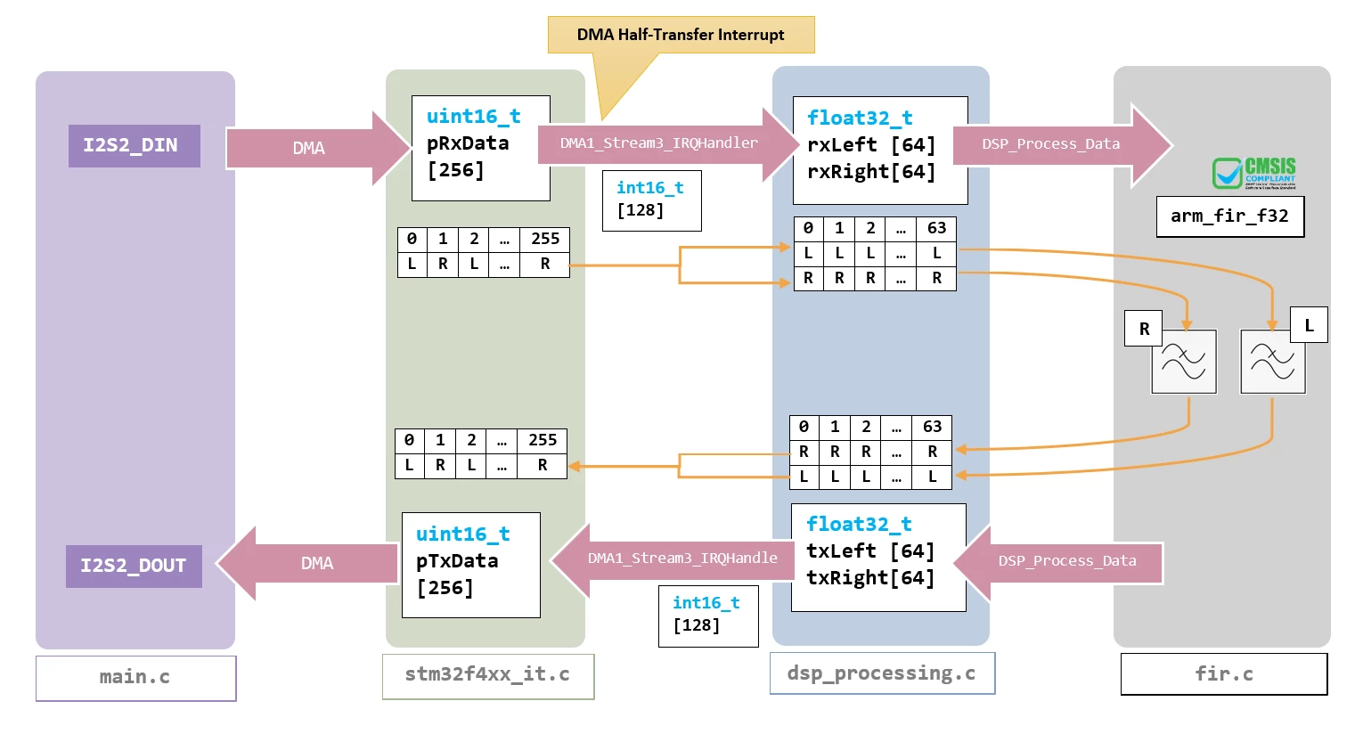

Best answer by Mnemocron
The input and output speed are the same. The TLV320 is in Master mode and outputs a 12.288MHz clock to the STM32. Rx/Tx happens at the same time.
The goal is to implement an FIR Filter (as opposed to an FFT in the replies to my question) so I need to modify the data.
I was now able to implement the DMA Buffer with an interrupt on half-full. Another issues was in how I implemented the FIR filter with the wrong parameters.
The DSP routine (including the FIR) is still called in the ISR as the processing time is much less than the buffer length times sampling period.
DMA runns on the pRxData[2 * DSP_BUFFERSIZE] and pTxData[2 * DSP_BUFFERSIZE]
void DMA1_Stream3_IRQHandler(void)
 /* USER CODE BEGIN DMA1_Stream3_IRQn 0 */
 /* DMA STREAM 3 is I2S2 RX complete */
 dmaTransferComplete ++;
 /* USER CODE END DMA1_Stream3_IRQn 0 */
 HAL_DMA_IRQHandler(&hdma_i2s2_ext_rx);
 /* USER CODE BEGIN DMA1_Stream3_IRQn 1 */
 // arm_fir_f32() is called in this function
 DSP_Process_Data( (pRxData + buffer_offset), (pTxData + buffer_offset), DSP_BUFFERSIZE);
 if(!buffer_offset)
 buffer_offset = DSP_BUFFERSIZE;
 else
 buffer_offset = 0;
 /* USER CODE END DMA1_Stream3_IRQn 1 */

Mnemocron
MnemocronAuthorBest answer
December 4, 2019
 if(!buffer_offset)
 else
 buffer_offset = 0;
